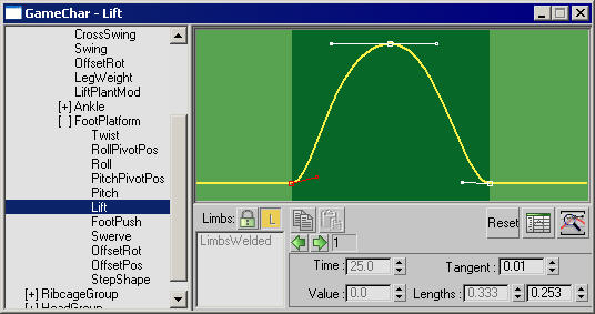

A FootPlatform
Lift controller
Make Unique (off/on) -
Divides the limbs into separate tracks.

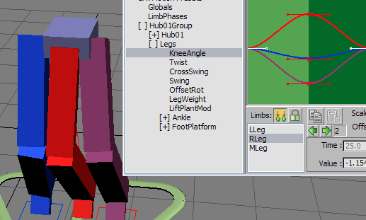

Below the Make Unique and Lock (see following) buttons is a box that provides access to individual limbs when Make Unique is on and Lock is off. In that context you can choose one of the list entries to make separate settings for that limb.
Left: Limbs welded (Make Unique off)
Center: Choose limb to adjust (Make Unique on/Lock off)
Right: Limbs locked (Lock on)
When you have control over the individual limbs, the curve for each limb is drawn in the same color as the limb itself.
Each curve uses the color of its respective limb.
Also, if you move a point directly on a curve, the respective limb highlights in the list.
Lock (off/on) -
Instances the settings between the different tracks. Available only when Make Unique is on.
(Previous)/
(Next) -
Click through the knots on the spline. You can also select a spline knot directly by clicking it in the window.
When you select a knot, its Time, Value, Tangent, and tangent Lengths settings are displayed and are ready for editing.
In some cases, settings are unavailable (grayed out), so cannot be edited.
Copies the settings for the current CATMotion controller.
Pastes settings from another CATMotion controller.
