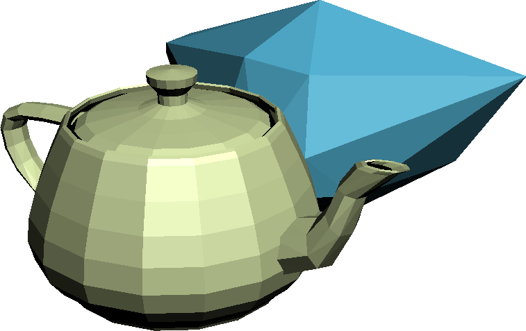

A graphical mesh (teapot) and its simplified physical shape
Without MassFX, every mesh in your scene is a graphical mesh: the visual representation of your object. To optimize a graphical mesh for a real-time game or faster render times, you would edit its polygons.
For physical simulation, you also want to be able to control the amount of information being processed. Often, the amount of information needed for simulation is far less than you need for the graphical representation. For example, as depicted in the preceding illustration, a (graphical) teapot might be represented by a simple convex (physical) hull, or shape, in the physics simulation.
A physical shape might be a collection of polygons, such as the one for the teapot, or it could be a simpler built-in shape. The available shapes in MassFX are Sphere, Box, and Capsule. Whenever possible, use these shapes for your physical shape, because they are both smoother and faster than a polygonal representation.
For example, a beach ball with a faceted convex hull for a physical shape will roll unevenly on the ground. Using the built-in Sphere physical shape to represent the ball lets it roll smoothly and yields better performance.

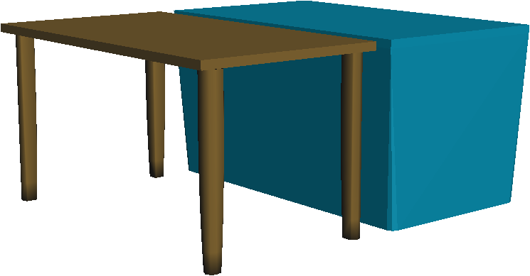

The following illustration shows a single graphical mesh for a wooden table. The single convex hull (the teal box), might work for the simulation as long as you don't need any chairs sitting at the table or objects trying to roll underneath it. If you do, and because dynamic rigid bodies can't use concave meshes (see the next section), you need to compose the physical representation from a set of joined physical shapes.
Table graphical mesh with convex physical shape

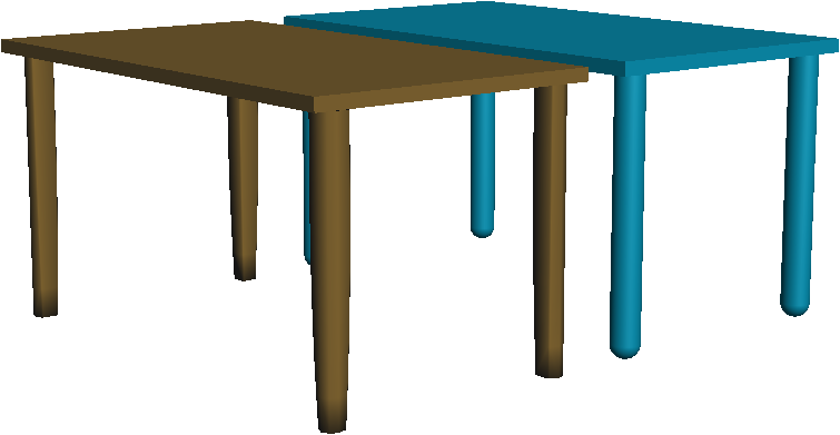

The next illustration shows the same table using one Box and four Capsule shapes for the physical representation.
Table graphical mesh with multiple physical shapes
