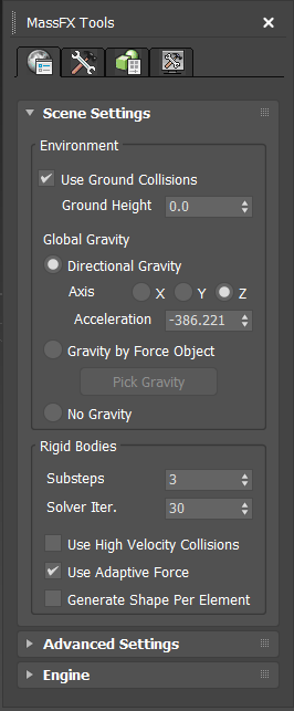

The MassFX Tools Dialog
The MassFX Tools dialog consists of four panels. You can open it directly to the panel of interest with the first flyout on the MassFX toolbar. The panels are:
- World Parameters Lets you control aspects common to the entire project using the Scene Settings, Advanced Settings, and Engine rollouts. For details, see MassFX Tools: World Parameters Panel.
- Simulation Tools Provides access to actions used during development of a simulation, such as Play, Reset, and Bake. For details, see MassFX Tools: Simulation Tools Panel.
- Multi-Object Editor Lets you adjust settings for multiple rigid bodies or constraints simultaneously. For details, see MassFX Tools: Multi-Object Editor Panel.
- Display Options Controls display properties common to the entire project. The Rigid Bodies rollout provides display options for all rigid bodies in the scene, and the MassFX Visualizer rollout provides tools for debugging simulations. For details, see MassFX Tools: Display Options Panel.

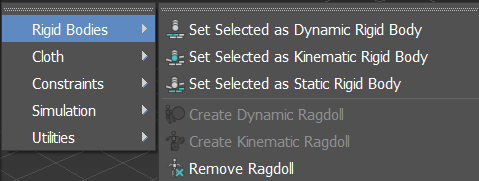

The Simulation - MassFX Submenu
The Simulation - MassFX submenu, available from the Animation menu, provides an alternative route to many features.
For more information, see MassFX Submenus.
