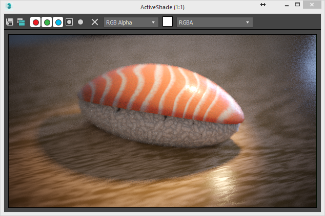

To create an ActiveShade rendering in its own floating window, choose the ActiveShade command from the Render flyout on the main toolbar.
The ActiveShade Floater is similar to the Rendered Frame Window, with a subset of the same controls.
You can open only one ActiveShade window at a time. Displaying a new ActiveShade window or viewport will close or revert the pre-existing instance.
