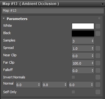

    Ambient Occlusion attributes

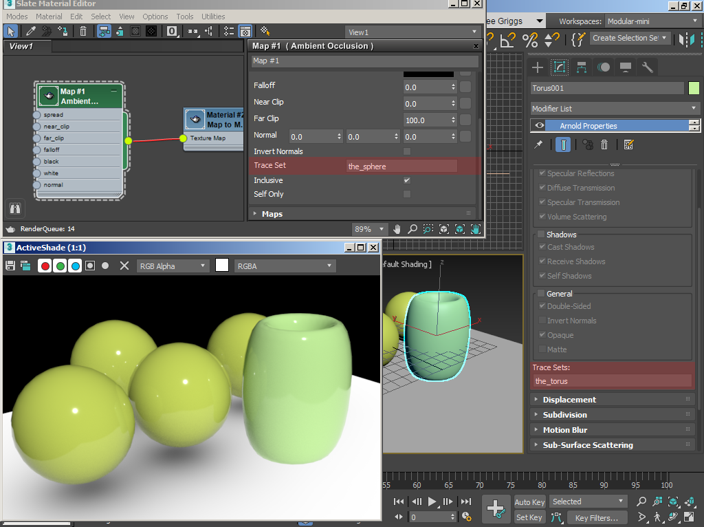

    Ambient occlusion is an approximation of global illumination that emulates the complex interactions between the diffuse inter-reflections of objects.
    Ambient occlusion excluded from Torus as 'the_sphere' is set in the shader
