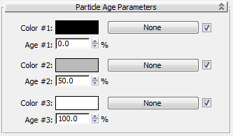

Interface
Color #1
Sets the color of a particle at its birth.
Click the button to the right of the color swatch to assign a map instead of a solid color. The checkbox turns the map on or off.
Age #1
Sets the age where a particle starts changing from Color #1 to Color #2, expressed as a percentage of the particle's entire life.
Color #2
Sets the color of a particle in mid-life. You can also assign a map to this color.
Age #2
Sets the age where a particle's color equals Color #2, expressed as a percentage of the particle's entire life.
Color #3
Sets the color of a particle at its death. You can also assign a map to this color.
Age #3
Sets the age where a particle changes to Color #3, expressed as a percentage of the particle's entire life.
