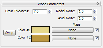

Wood Parameters rollout
Defaults: Grain Thickness=7, Radial Noise=1.0, Axial Noise=1.0
Grain Thickness
Sets the relative thickness of the color bands that make up the grain. Default=7.
The effect of thickness is relative to the context of the object. A grain that appears unrealistically wide on a small table might be acceptable on a large overhead beam.
Decreasing Grain Thickness creates grain lines that are closer together. The effect can resemble the fine grain of slow-growth hardwoods. At 0, grain disappears, resulting in what can look like composition board made from sawdust.
Increasing Grain Thickness creates grain lines that are farther apart. The effect can resemble tropical woods that grow continuously.
Grain thickness is shown increasing with identical noise settings.
Grain Thickness=1, 3
Radial, Axial Noise=1 (defaults)
Grain Thickness=7 (default), 14

Swap
Exchanges the position of the colors.
Colors
Selects any two colors for the grain pattern. Defaults=brownish yellow for Color #1 and dark brown for Color #2. Either color can be replaced or swapped.
The choice of colors, along with grain pattern, is the primary way to represent different types of wood. In fairly uniform woods like yellow pine or redwood, the two colors are often near the same settings (examples B and C). Lighting also makes a difference in the apparent colors.
A: Default colors
B: Color #1=RGB 160,125,50
Color #2=RGB 170,135,25
C: Color #1=RGB 140,90,0
Color #2=RGB 130,80,50
Grain Thickness=3
Other settings at defaults
Maps
Replace colors with maps. The checkboxes enable or disable their associated maps.
You can assign maps to one or both of the Wood color slots. Any kind of map can be used, including Wood. The map overrides the assigned color, which has no effect.
The left box uses defaults. The right box is the same, except that Color #1 has been replaced with a Checker map, whose colors have been changed to wood tones.
Left: Default
Right: Color #1 replaced with Checker map
Grain Thickness=3
