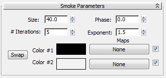

Size
Changes the scale of the smoke "clumps." Default=40.
# Iterations
Sets the number of times the fractal function is applied. The higher the value, the more detail within the smoke, but the longer the calculation time. Default=5.
Phase
Shifts the turbulence within the smoke pattern. Animate this parameter to animate the movement of the smoke. Default=0.0.
Exponent
Makes color #2, representing the smoke, sharper and more wispy. As this value increases, the smoke "tendrils" become smaller within the pattern. Default=1.5.
Swap
Exchanges the colors.
Color #1
Represents the smokeless portion of the effect.
Color #2
Represents the smoke.
Because this map is usually used as an opacity map, you can adjust the luminance of the color values to alter the contrast of the smoke effect.
  • Click a color swatch to change the color. Usually you only need to do this to adjust luminance.
  • Click a map button to assign a map instead of a solid color. Turn on the checkbox to activate the map.
