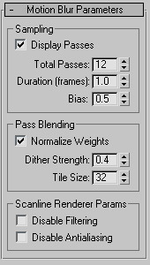

Sampling group
Display Passes
When on, the rendered frame window displays the multiple rendering passes. When off, the frame window displays only the final result. This control has no effect on previewing motion blur in camera viewports. Default=on.
Total Passes
The number of passes used to generate the effect. Increasing this value can increase the effect's accuracy, but at a cost of rendering time. Default=12.
Duration (frames)
The number of frames in the animation to which the motion blur effect will be applied. Default=1.0.
Bias
Changes the blurring so that it appears to derive more from frames before or after the current frame. Range=0.01 to 0.99. Default=0.5.
By default, the blurring comes equally from frames before and after the current frame; that is, a blurred object appears at the center of the blurred area. This is the closest to what an actual camera would capture. Increasing the Bias value moves the blurring behind the blurred object, in relation to its direction of motion. Decreasing it moves the blurring in front of the blurred object.
Extreme values move most of the blurring very close to the blurred object, which makes it difficult to see. For best results, use intermediate Bias values in the range 0.25 to 0.75.
Pass Blending group
The multiple motion blur passes are blended by dithering, which you can control by the parameters in this group.
These controls apply only to renderings of the motion blur effect, not to previews in viewports.
Normalize Weights
Passes are blended with random weighting to avoid artifacts such as streaking. When Normalize Weights is on, the weights are normalized, giving a smoother result. When off, the effect is a bit sharper but usually grainier. Default=on.
Dither Strength
Controls how much dithering is applied to the rendered passes. Increasing this value increases the amount of dithering, and can make the effect grainier, especially at the edges of objects. Default=0.4.
Tile Size
Sets the size of the pattern used in dithering. This value is a percentage, where 0 is the smallest tile, and 100 is the largest. Default=32.
Scanline Renderer Params group
These controls let you disable antialiasing or antialias filtering when you render the multi-pass scene. Disabling these rendering passes can improve render time.
Disable Filtering
When on, disables the filtering pass. Default=off.
Disable Antialiasing
When on, disables antialiasing. Default=off.
