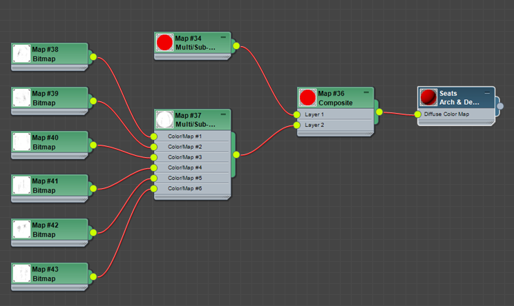

In the Slate Material Editor, you can view the Material/Map tree as a node graph.
A four-level tree that uses Multi/Sub maps and a Composite map
