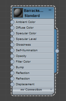

  1. Start with a plain material.
    Building with default materials
    Node for a single Standard material

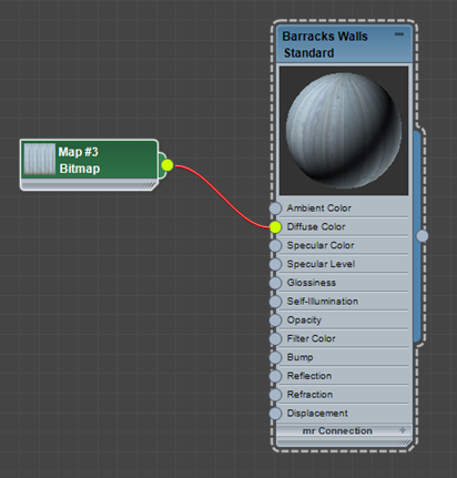

  2. Apply a bitmap to the material’s Diffuse component (the texture map).

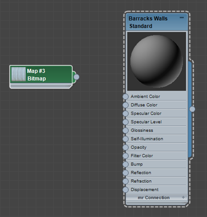

    Planks bitmap for the wall texture
    A Bitmap node added to the active View

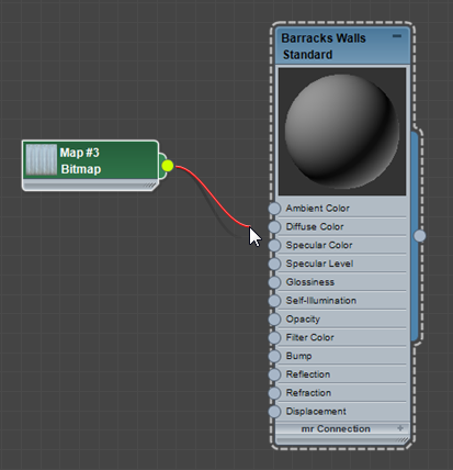

    Dragging from the output socket of the Bitmap node creates a wire.
    Dropping the wire on the Diffuse Color input socket applies that map to the material’s diffuse color component.

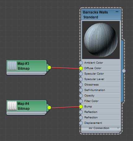

  5. Apply a map to the material’s Bump component (the bump map).
    Bitmap for adding bumps to the plank material
    (This is simply the same image saved as black-and-white.)
    Bump map added to the material tree
