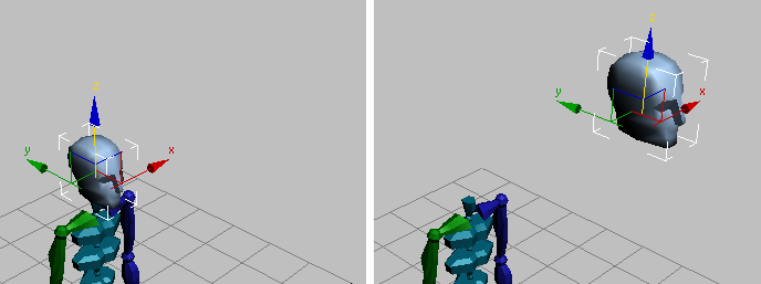

Moving the Head
In Figure mode you can move the head relative to the body. This is another way to help fit the biped into a character’s skin.
Moving a biped’s head in Figure mode
