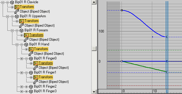

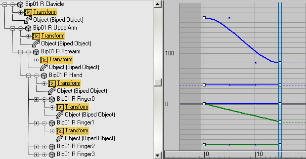

By default, Biped uses an optimized method for storing animation keys. For example, keys for the fingers, hand, forearm, and upper arm are stored in the Clavicle transform track. If you prefer instead to have a transform track available for each arm object, use the Separate FK Tracks settings to make these transform tracks available; separate tracks are displayed in Track View.
![]() When the Separate FK Tracks options are on for the Arms and Fingers, only these tracks receive keys. |
![]() When the Separate FK Tracks options are off, all limb tracks receive keys. |

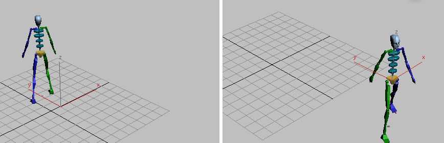

Mirror and Mirror In Place flyout - This flyout offers two options. Both options mirror the animation locally, so that the right side of the biped now does what the left side does, and vice versa. Also, if the spline leaned to the left, it now leans to the right. The same goes for the neck, pelvis, head, and so on.
Mirror Reflects the animation about the world-space XZ plane. This option reverses the biped’s position by 180 degrees, so it now faces in the opposite direction. -
Mirror in Place Reflects the animation locally, but at the initial frame, maintains the world-space position and orientation of the biped. The biped continues to face in the same direction.
Original animation: The biped turns to the left as it walks.
Left: When you click Mirror, the animation and the biped turn completely around.
Right: When you click Mirror In Place, the biped still moves forward, but now it turns to the right.

Separate FK Tracks group
By default, character studio stores a finger, hand, forearm, and upper-arm key in the Clavicle track. The toe, foot, and calf keys are stored in the thigh track. This optimized approach to key storage works well in most cases. If you need extra tracks, turn them on for a specific biped body part. For example, turn on Arms if you plan to create extensive finger-hand animation; if an arm key is deleted, it will not affect the finger-hand keys.
You must turn on Set Parents Mode for these toggles to take effect.
- Arms
- Turn on to create separate transform tracks for the finger, hand, forearm, and upper arm.
By default, there is one finger track per hand. All finger keys are stored in the Finger0 transform track, the first link of the biped thumb.

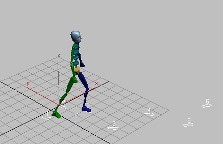

- Bend Horizontal
- Rotates selected keys horizontally about their up-axis. To use this, select the biped's COM, turn on
(Trajectories) to see the path, use the Time Slider to select keys, and then adjust the Bend Horizontal value. The path curves. Bend Horizontal is a relative value: After you adjust it, it returns to 0.0.
