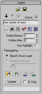

Select your biped and on the
Motion panel, expand the Layers rollout.
Create a new layer and name it
Low center of mass.
The
(Retarget Left Arm) button in the Retargeting group becomes active, which indicates that the current layer honors the IK constraint of the base layer for this body part.
- Turn on
- On the Track Selection rollout, turn on
(Body Vertical).
This selects the biped's center of mass.
Lower the center of mass on the Z axis until the biped's head is under the base layer's head display (represented as a red box).
Tip: To avoid deselecting the center of mass, you can lock it by clicking the
(Selection Lock Toggle) (or press
Ctrl+Shift+N).
The entire biped is lowered except its left hand, which remains locked to the object because the current layer retargets it to match the respective IK constraint of the base layer.
Only the biped's left hand constraint is honored.
- In the Retargeting group, turn on both
(Retarget Left Leg) and
(Retarget Right Leg). Then click Update.
The biped's IK feet are adjusted to match those of the base layer. The animation keys are updated to reflect the current layer's retargeted feet.
Tip: If some body parts assume odd positions, simply drag the time slider a few frames past your current frame, and then drag it back home.
Both the biped's feet and left hand constraints are honored.
- You can continue animating the biped to your liking.
Collapse your layers when you are satisfied.
This procedure takes into account the fundamentals of animating across layers and expands on the concept of honoring IK constraints.

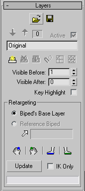

Interface
[Load and Save buttons]
You can load and save individual biped layers as BIP files.
Load Layer - Click to display a
Biped Open dialog and open a BIP file for the active layer.
3ds Max objects and list controllers are loaded only at the base layer (0). When you load into a higher layer, separate tracks are removed, and IK is removed for any limb.
If Retarget is on for a limb, the limb keys are removed. After you load a layer, retargetting does not happen automatically: you must click Update after you load the layer.
Save Layer - Opens the
Biped Save As dialog and save the current layer’s animation in a BIP file.
3ds Max objects are saved only at the base layer (0).
Previous Layer / Next Layer - Navigate through the layers by clicking the up and down arrows. The current layer number appears in the numeric field next to the arrow buttons.
Note: 3ds Max plays animation for the selected biped only from the active layer and the active layers below it. So, for example, if the biped contains animation in four active layers—0, 1, 2, and 3—and the current layer is layer 2, playing the animation shows the animation in layers 0, 1, and 2, but not layer 3.
- [Layer Number]
- Displays the number of the current layer.
- Active
- Toggles the current layer. Unavailable for layer 0, which is always active.
- [name field]
- Type a name to easily identify a layer.
Create Layer - Creates a layer above the current layer, and increments the Layer Number field.
Position the biped to create keys in a layer.
Delete Layer - Deletes the current layer.
All layer numbers above the one deleted are decremented by one.
Collapse Layers - Combines the animation in the current layer into that in the next-lowest active layer and then deletes the current layer.
For instance, if layer 3 is the current layer and layer 2 is inactive, collapsing layer 3 moves its animation data into layer 1 and then deletes layer 3.
Snap Set Key - Snaps the selected biped part to its original position in layer 0 and creates a key.
Use this in higher layers to return the selected biped part to the original motion. For example, if a layer has a posture key that bends the character forward at frame 2 and you want to return the biped to its original posture motion at frame 50, use Snap Set Key at frame 50 with a spine object selected. The character will interpolate from its forward posture position to its original posture position between frames 2 and 50.
Activate Only Me - Enables viewing only the animation in the current layer and in layer 0.
Activate All - Activates all layers.
Playing the animation shows a composite of all the layers.
- Visible Before
- The number of preceding layers to display as stick figures.
- Visible After
- The number of succeeding layers to display as stick figures.
- Key Highlight
- Displays keys by highlighting the stick figures.

- Biped's Base Layer
- Choose this method to use the IK constraints from the selected biped's original layer as retarget reference. Default=active.
- Reference Biped
- Choose this method to use the biped whose name is displayed next to the Select Reference Biped button as retarget reference.
Select Reference Biped - Lets you choose a biped to use as retarget reference for the selected biped. The chosen biped's name is displayed next to the button.
Retarget Left Arm - When on, the IK constraints of the base layer are honored for the biped's left arm.
Retarget Right Arm - When on, the IK constraints of the base layer are honored for the biped's right arm.
Retarget Left Leg - When on, the IK constraints of the base layer are honored for the biped's left leg.
Retarget Right Leg - When on, the IK constraints of the base layer are honored for the biped's right leg.
- Update
- Calculates the selected biped's hands and feet positions for every set key based on the retarget method (Base Layer or Reference Biped), the active retarget body parts buttons, and the IK Only option.
- IK Only
- When on, the biped's constrained hands and feet are retargeted only during the frames on which they are IK controlled. When off, the hands and feet are retargeted during both IK and FK keys. Default=off.
