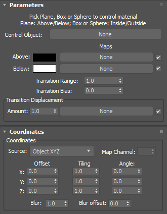

Control Object
Selects a control object from the scene. Can be a plane, box or sphere.
Above/Inside
Selects the color of the material to be placed above the surface of the plane or inside the box or sphere. Alternatively, enable the check box to use a selected map.
Below/Outside
Selects the color of the material to be placed below the surface of the plane or outside the box or sphere. Alternatively, enable the check box to use a selected map.
Transition Range
Sets a transition for blending the colors or maps.
Transition Bias
Expands or contracts the masked area.
Transition Displacement
Displaces the masked area with a selected map.
