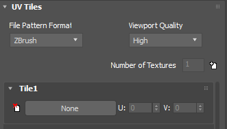

UV Tiles rollout
- File Pattern Format
- Selects a file pattern format: Zbrush, Mudbox, UDIM (Mari) or Custom.
Use Custom when selecting image file types such as jpegs and bitmaps.
- Viewport Quality
- Selects the viewport display quality.
- Number of Textures
- Shows the current number of texture tiles.
Add Tile button- Click to add tiles.
Delete Tile button- Click to delete a tile.
- Tile button
- Click the Tile button to select a file to as a new tile. The button shows the name of the currently-selected file or None if no file has been selected.
- U V
- Enter values to position the tile in the UV editor, with the values corresponding to UV space. For example, enter 0,0, or 1,0, or any other desired value such as 4,4 etc..
Note: In the UV Editor preferences, make sure a high enough number of tiles are set in the Display Preferences and that Tile Bitmap is enabled in the Unwrap Options dialog, otherwise the additional tiles may not show correctly.
