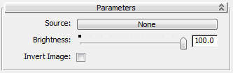

Parameters rollout
Source
Opens a Select Bitmap Image File dialog so you can choose an image file to use for the map. You can choose any file type that 3ds Max supports.
Brightness
You can use the brightness slider or numeric field to decrease the brightness of the image. At the default of 100 percent, the map has its original tones. Default=100.0 percent.
Invert Image
Inverts the colors of the image.

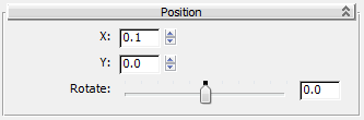

Position rollout
X, Y
Offset the image along the local XY axes in 3ds Max units.
Rotate
Rotates the image around the local Z axis. Default=0.0.

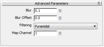

Advanced Parameters rollout
Blur
Affects the sharpness or blurriness of the map based on its distance from the view. The farther away the map is, the greater the blurring. The Blur value blurs maps in world space. Blur is primarily used to avoid aliasing. Range: 0.01 to 100. Default=0.1.
Blur Offset
Affects the sharpness or blurriness of the map without regard to its distance from the view. Blur Offset blurs the image itself in object space. Use this option when you want to soften or defocus the details in a map to achieve the effect of a blurred image. Range: 0.0 to 1.0. Default=0.0.
See Blur/Blur Offset.
Filtering
Lets you choose the filtering (antialiasing) method used for the bitmap.
  • Pyramidal (the default)
  • Summed Area
  • None
Map Channel
Assigns a map channel value to the map. Range: 1 to 99. Default=1.
