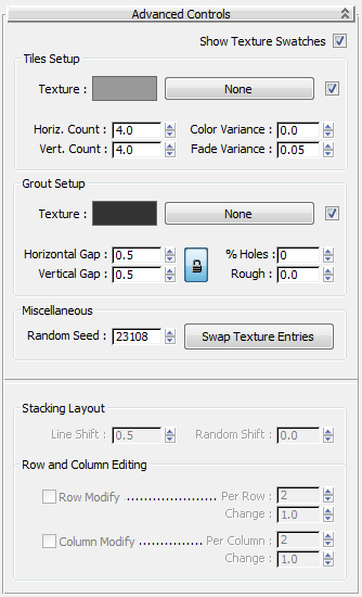

Advanced Controls rollout
- Show Texture Swatches
- When on, the Texture swatch for Tiles or Grout updates to show the map you assign. Default=on.
Tiles Setup group
- Texture
- Controls the display of the current texture map for the tiles. When on, the texture is used as the tile pattern instead of the color swatch. When turned off, the color of the tiles is displayed; clicking the color swatch displays the Color Selector.
- [Texture button]
- Acts as a target where you drag and drop maps for the tiles. When you click this button with a map assigned,
3ds Max displays the rollout for the map. Before a map is assigned, the label reads "None."
The checkbox controls whether the map is used or not.
- Horiz. Count
- Controls the number of tiles in a row.
- Vert. Count
- Controls the number of tiles in a column.
- Color Variance
- The greater this value, the greater the color varies among individual tiles. Range: 0.0 to 100.0. Default = 0.0.
Left: Color Variance = 0.0
Right: Color Variance = 1.0
- Fade Variance
- The greater this value, the greater the color of individual tiles is "faded" or desaturated. Range: 0.0 to 100.0. Default = 0.05.
Left: Fade Variance = 0.05
Right: Fade Variance = 1.0
Grout Setup group
- Texture
- Controls the display of the current texture map for the grout. When on, the texture is used as the grout pattern instead of the color swatch. When off, the color of the grout is displayed, and clicking the color swatch displays the Color Selector.
- [Texture button]
- Acts as a target where you drag and drop maps for the grout. When you click this button with a map assigned,
- Horizontal Gap
- Controls the horizontal size of the grout between the tiles. This value is locked by default to the vertical gap, so that both values change as you edit one or the other. To unlock them, click the lock icon.
- Vertical Gap
- Controls the vertical size of the grout between the tiles. This value is locked by default to the horizontal gap, so that both values change as you edit one or the other. To unlock them, click the lock icon.
- % Holes
- Sets the percentage of holes in the tiled surface caused by missing tiles. The grout shows through the holes.
- Rough
- Controls the roughness of the edges of the grout.
Miscellaneous group
- Random Seed
- Randomly applies patterns of color variation to the tiles. Does not require any other setting to generate completely different patterns.
- Swap Texture Entries
- Swaps the texture maps or colors between the tiles and the grout.
