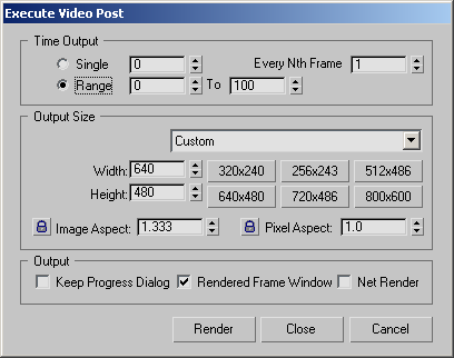

To execute the queue:
  1. Click (Execute Sequence).
    An Execute Video Post dialog appears.
  2. Set the time range and output size, and then click Render to create the video.
  3. When execution is done, click Close to dismiss the Video Post progress dialog if it is still open.
Interface
Time Output group
Select the frames to execute:
  • Single Current frame only.
    You can execute a single frame only if it falls within the current range.
  • Range All the frames between and including the two numbers.
    Every Nth Frame Regular sample of frames. For example, enter 8 to execute every 8th frame.
Output Size group
[format drop-down list]
Choose Custom or a standard film or video format from the list. For Custom, you can set the aperture width of the camera, the rendering output resolution, and the image aspect ratio or pixel aspect ratio. When you choose a standard format, the aperture width and aspect ratios are locked, but you can change the resolution.
Width/Height
Specify the width and height of the image, in pixels. For Custom, you can set these two spinners independently. For other formats, the two spinners are locked to the specified aspect ratio, so changing one changes the other.
Resolution Buttons
Specifies a preset resolution. Right-click a button to display a subdialog that lets you change the resolution specified by that button.
Image Aspect
Sets the aspect ratio of the image. As you alter the Image Aspect, you also alter the Height value to maintain the correct aspect ratio. For standard formats, the image aspect ratio is locked, and this spinner is replaced by a text display.
If you lock the Image Aspect (by clicking the Lock button), Width and Height are locked to each other, so that changing one changes the other to maintain the image aspect ratio, and changing the Pixel Aspect value changes the Height value to maintain the image aspect ratio.
Pixel Aspect
Sets the aspect ratio of the pixels of the image. For standard formats, the pixel aspect ratio is determined by the format and this spinner is replaced by a text display.
If you lock the pixel aspect ratio (by clicking the Lock button), the Pixel Aspect spinner is replaced by a text display. The Lock button is available only for the Custom format.
Output group
Keep Progress Dialog
Forces the Video Post Progress dialog to remain displayed when the Video Post sequence has finished executing. By default, it closes automatically. If this option is selected, you must click the Close button to close the dialog.
Rendered Frame Window
Displays the Video Post execution in a window on the screen.
Net Render
Enables network rendering. If Net Render is turned on, when you render you'll see the Network Job Assignment dialog.
