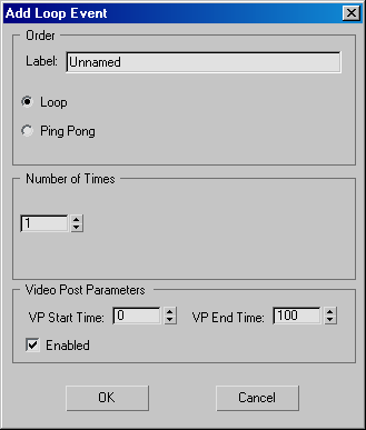

The Add Loop Event and Edit Loop Event dialogs have the same controls.
Order group
- Label
- Lets you give the event a unique name. A unique name can make it easier to distinguish the loop event in a long list of events.
- Loop (The default.) Repeats the child event by starting it over when the child event reaches the end of its range.
- Ping Pong Repeats the child event by playing it first forward, then backward, then forward, and so on. The last frame of the child event is not repeated.
Number of Times group
Specifies the number of times to repeat the loop or ping pong, in addition to the first time that the child event is played.
Video Post Parameters group
- VP Start Time/End Time
- Set the starting and ending frames for the selected event within the overall Video Post queue. Video Post renders the event over the number of frames specified here.
- Enabled
- Enables or disables the event. When turned off, the event is disabled and Video Post ignores it when rendering the queue. Each event must be disabled individually. For example, disabling a composite layer event does not disable the composited image events. The range bars of disabled events are unavailable in the event track area.
