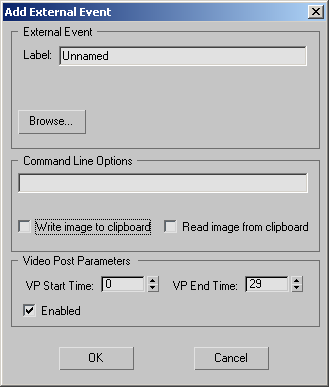

To add an external event:
  1. Select an event.
  2. Click (Add External Event).
    An Add External Event dialog appears.
  3. Click Browse.
    A file dialog appears.
  4. Use the file dialog to choose the external program you want to execute, and then click OK.
  5. If the external program accepts command-line options, enter these in the Command Line Options field.
  6. If you want the external program to read the current Video Post image, turn on Write Image To Clipboard.
  7. If you want Video Post to use the result of the external program, turn on Read Image From Clipboard.
  8. Click OK.
    If you selected an event, the External event becomes its child. If no event was selected, the External event appears at the end of the queue.
Warning: The image that the External event reads from the clipboard is placed in the Video Post queue. If the external program does not do what you want, this can erase or overwrite the result of all Video Post post-processing.

The Add External Event and Edit External Event dialogs have the same controls.
External Event group
Label
Lets you give the event a unique name. A unique name can make the external event easier to distinguish in a long list of events.
Browse
Lets you select an external program. For example, you can specify Adobe Photoshop™ or another image-processing application.
Command-Line Options group
For external programs that accept command-line options, lets you send real-time data to the external program. 3ds Max parses three special commands. When found in a string, these commands are replaced with real-time data, as follows:
  • %f is replaced with a 4-digit frame number (for example, 0001)
  • %w is replaced with a 4-digit image width (for example, 0640)
  • %h is replaced with a 4-digit image height (for example, 0480)
For example, if the given command-line option is:
-w%w -h%h -oframe%f.tga
The string sent to the external program might be:
-w0640 -h0480 -oframe0001.tga
Write image to clipboard
When on, writes the current rendered image to the Windows clipboard for retrieval by an external application.
Read image from clipboard
When on, reads the contents of the Windows clipboard after processing by the external application. When the processed image is saved to the clipboard, it automatically appears in Video Post. With an automated script, it is possible to run the image through any external image processor and get it back automatically.
Video Post Parameters group
VP Start Time/End Time
Set the starting and ending frames for the selected event within the overall Video Post queue. Video Post renders the event over the number of frames specified here.
Enabled
Enables or disables the event. When turned off, the event is disabled and Video Post ignores it when rendering the queue. Each event must be disabled individually. For example, disabling a composite layer event does not disable the composited image events. The range bars of disabled events are unavailable in the event track area.
