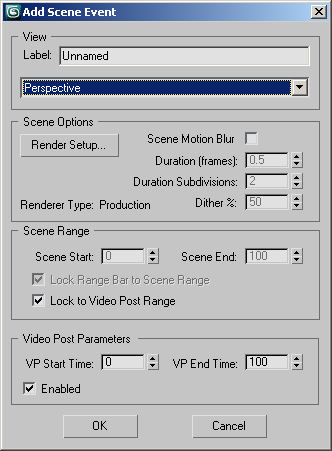

To add a Scene event:
  1. Make sure no events are selected in the queue.
  2. Click (Add Scene).
    An Add Scene Event dialog appears.
  3. Choose a view to use from the View list.
  4. Click Render Setup to change rendering settings from the way you have set them in the Render Setup dialog.
    Note: Unlike settings in the Execute Video Post dialog, changes you make to the Scene event rendering options change the Render Setup dialog settings, and vice-versa.
  5. Set the Scene Range options and click OK.
    The Scene event appears at the end of the queue.

Interface
The Add Scene Event and Edit Scene Event dialogs have the same controls.
View group
Label
Lets you edit the event name. A unique name can make the scene event easier to distinguish in a long list of events.
[viewport drop-down list]
Choose the viewport you want to render.
Scene Options group
Enables various rendering effects.
Render Setup
Displays a subset of the Render Setup dialog parameters. Changes you make here affect the Render Setup dialog as well.
Scene Motion Blur
Turns on the scene motion-blur effect for the whole scene. This is different from object motion blur, which creates motion blur for individual objects in the scene.
When you render with Scene Motion Blur activated, the Render Progress dialog tells you which subsample is being rendered. The information appears in parentheses to the right of the "Rendering Image" text.
Duration
Sets the virtual shutter speed for motion blur. When set to 1.0, the virtual shutter is open for the entire duration between one frame and the next. When set to a smaller number, such as 0.25, the number of subdivisions specified in the Duration Subdivision field will be rendered within the specified portion of the frame (in this example, in the first fourth of the duration between one frame and the next).
Duration Subdivisions
Determines how many sub-frame slices are rendered within the Duration. The default is 2 slices, but you'll want at least 5 or 6 to get a decent effect.
Dither %
Sets the amount of dithering between blurred pixels of overlapping frame slices. If Dither % is set to 0, no dithering occurs.
Scene Range group
Scene Start/End
Sets the range of scene frames to be rendered.
Lock Range Bar to Scene Range
Becomes available when you deselect Lock To Video Post Range. When it's available, the End spinner is disabled and locked to the Video Post range. When you change the Start spinner it automatically updates the End spinner based on the Video Post range set for this event.
If you turn off Lock Range Bar To Scene Range, you can change either Start or End spinners to whatever you want. This allows you to keep your scene range locked to its native length, and still provides flexibility for mapping an arbitrary scene range to an arbitrary Video Post range.
Lock to Video Post Range
Renders the same range of scene frames as Video Post frames. You can set the Video Post range in the Execute Video Post dialog.
Video Post Parameters group
VP Start Time/End Time
Sets the starting and ending frames for the selected event within the overall Video Post queue. Video Post renders the event over the number of frames specified here.
Enabled
Toggles the event. When off, the event is disabled and Video Post ignores it when rendering the queue. You must disable each event individually. For example, disabling a composite layer event does not disable the composited image events. The range bars of disabled events are unavailable in the event track area.
