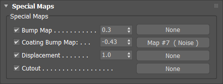

Special Maps Rollout (Physical Material)
The Physical Material's Special Maps rollout allows you to use a special map in the creation of your physical material.
  • Material Editor > General > Physical Material > Special Maps rollout
Each setting has a checkbox for enabling/disabling the map and a button to define the map.
Interface
Bump Map
Click the map button to assign a Bump map. Use the multiplier value to adjust the strength of the bump effect.
Coating Bump Map
Click the map button to assign a Bump map to the coating layer. Use the multiplier value to adjust the strength of the bump effect.
Displacement
Click the map button to assign a Displacement map. The numeric setting is a multiplier value for adjusting the strength of the displacement effect.
Cutout
Click the map button to assign a Cutout map. For example, you can use this feature to map an image of a tree to a flat plane and use opacity to cut away parts of the tree that are not there.
