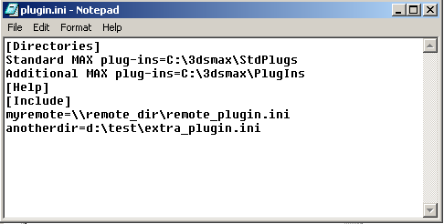

Example: To add remote INI files to your local plugin.ini:
  1. Open your local copy of plugin.ini with a text editor.
  2. At the bottom of the file, type [Include] and press Enter.
  3. After [Include], type these two lines:
    myremote=\\remote_dir\remote_plugin.ini
    anotherdir=d:\test\extra_plugin.ini
    Note: You can give any title to the directory (in this case, myremote or anotherdir), and the directory can be any local or remote directory. In addition, the INI file can have any name.
  4. Save plugin.ini and exit the text editor.
    The next time you start 3ds Max, it will load plug-ins from the directories defined in plugin.ini as well as plug-ins in any remote INI file specified in plugin.ini.
