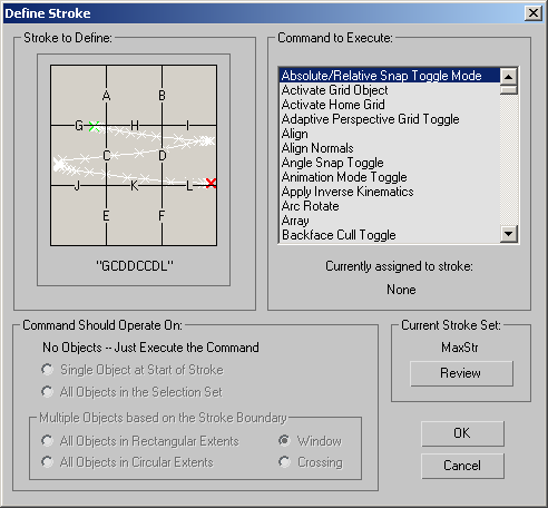

In the Define Stroke dialog, you can see how the strokes are analyzed by examining the grid under Stroke to Define. When you complete the drawing of a stroke, a nine-square grid is centered around the stroke and fit to its extents. The inner segments of the grid are assigned unique letters. Where the stroke crosses a segment, the letter associated with that segment is added to the stroke name. Thus, the direction and the shape of the stroke matter, but the size of the stroke has no effect.
The stroke is always centered within the grid. If you draw a stroke vertically from top to bottom, the stroke is named HK because it crossed the segments labeled H and K, in that order. Had you drawn the stroke from bottom to top, it would have been named KH.

To define a stroke by example:
- Draw a stroke that doesn't exist.
- A Stroke Not Found message appears. Click Define.
- In the Define Stroke dialog that appears, assign the stroke.
Interface
Stroke to Define group
Displays the name of the stroke and displays the stroke you just drew as a series of white Xs connected by white lines. A green X represents the start of the stroke and a red X represents the end. The labeled grid shows you how it recognizes the stroke. Where the stroke crosses the labeled segments in the grid, a letter is added to the name of the stroke.
Command to Execute group
Lists all commands to which you can assign a stroke. Select a command and click OK to assign the stroke displayed in the grid to the selected command. Depending on the type of command you choose in this list, various options become available in the Command Should Operate On group.
Some commands have special-purpose methods associated with them. See Commands with Special-Purpose Methods.
- Currently assigned to stroke
- Displays the name of the stroke currently assigned to the selected command. If you pressed Shift or Alt when the stroke was drawn, they're added to the name. For example: "Shift + HK" or "Alt + HK."
