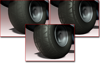

Upper left: No highlights
Upper right: Single highlight
Lower middle: Multiple highlights from the multi-layer shader
