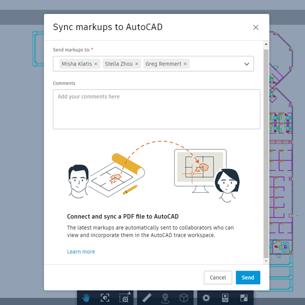

  1. In Autodesk Docs, in the Files tool, open a PDF with published markups.
  2. Select Sync markups to AutoCAD.
  3. Choose who will receive the markups and add any comments.
  4. Click Send.
Recipients will receive an email from Autodesk Construction Cloud with a link to the AutoCAD drawing.

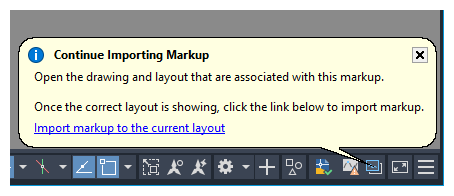

  6. If AutoCAD is unable to detect the drawing and layout associated with the PDF:
    You'll need to manually select the drawing and layout on which to import the markup.
  7. Open the drawing and layout onto which you would like to import the markup.
  8. Once the correct layout is displayed, click the link in the notification to import the markup onto a new trace.
