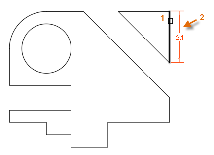

  2. Hover over a line segment until the dimension preview is displayed. Select the line segment, and then click the desired location for the dimension line.
    Note: If object snaps are interfering with object selection or dimension placement, either zoom in or press F3 to turn off running object snaps.

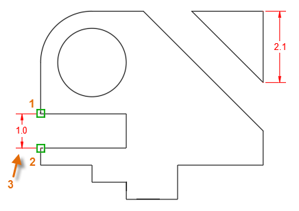

  3. To dimension gaps, use object snaps to locate dimension points (1,2) and click the desired location for the dimension line (3).

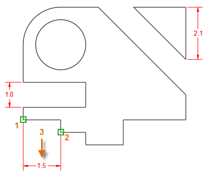

  4. For the next linear dimension, use the object snaps (1,2) and click the desired location for the dimension line (3).

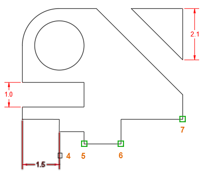

  5. To create a continuous line of dimensions, specify the Continued option at the prompt, select the extension line from which to continue (4), and the other dimension points (5,6,7).
    Note: The sequence to create a baseline dimension is similar, except that (a) the Baseline option would be chosen and (b) the extension line selected would be the one to the left of (4).
  6. Then press Enter twice to end the sequence of continued dimensions.

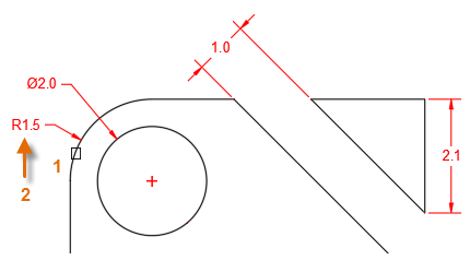

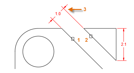

  7. Next, we'll dimension the width of the diagonal slot or passage. Select the diagonal lines (1,2) and then click the location for the dimension line (3).
  8. To dimension the fillet and the circle, select it and then click the location for the text and leader.
  9. Finally, press enter to exit the DIM command.
