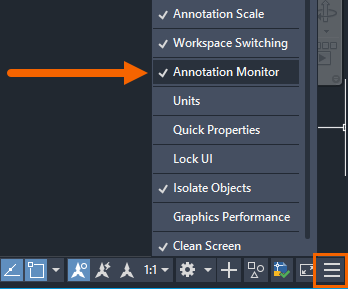

Click the Annotation Monitor status bar button to turn the annotation monitor on and off .
When the annotation monitor is active, the Annotation Monitor icon is added to the status bar.
If you don't see the Annotation Monitor status bar button, click Customization , located at the far-right end of the status bar, and select Annotation Monitor.

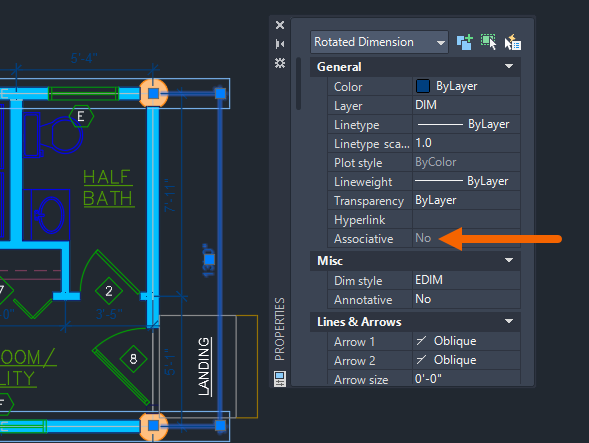

When the annotation monitor is off, there's no visual indicator that displays if a dimension is associative or non-associative. You can use the Properties palette or LIST command to verify the status of a dimension.

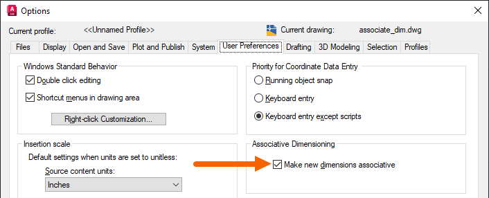

By default, all new dimensions are associative. This can be changed in the Options dialog box.
  1. Click Application menu > Options
  2. In the Options dialog box, User Preferences tab, under Associative Dimensioning, verify that Make New Dimensions Associative is checked.
  3. Click OK.
Note: You can also change associative dimensioning by typing DIMASSOC at the Command prompt.

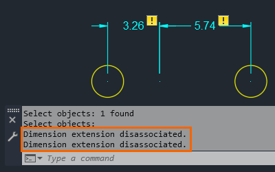

Example of a Disassociated Dimension
Let's walk through an example of how a dimension can become disassociated.
Verify that the annotation monitor is on.
  1. Create a new drawing and add three circles and two dimensions like the example below.
  2. Try moving the middle circle to the left.
    See how the dimension values change. That's because the dimensions are associated to the centers of the three circles.
  3. Now erase the middle circle.

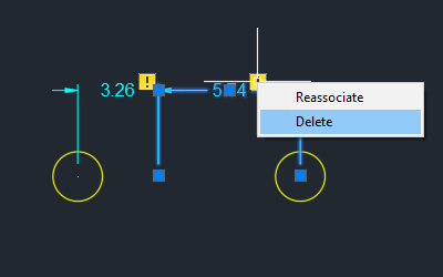

    A yellow badge is displayed on the dimensions indicating they are no longer associated to the circles. Deleting the middle circle created two disassociated dimensions.
Working with Disassociated Dimension
Due to a design change, we now have two disassociated dimensions. To fix this, we'll delete the dimension that's no longer needed and reassociate the other dimension to the remaining circles.

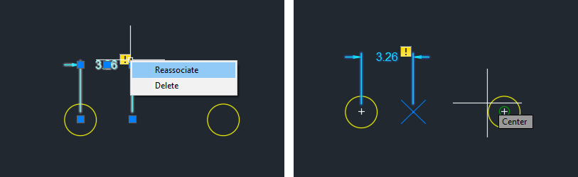

There are two ways to do this, one is from the ribbon and the other is clicking the yellow badge on the dimension. Both methods are similar. In the example below, let's click the yellow badge and use the menu.
  1. Click the yellow badge and choose Delete from the menu to remove this dimension that's no longer needed.
  2. Click the yellow badge on the remaining dimension and choose Reassociate from the menu.
    Use object snaps to accurately select the center of the circles to reassociate the dimension to the circles.
    Notice that the yellow badge is no longer displayed on the dimension. This indicates that the dimension is now associated with the centers of the two circles.

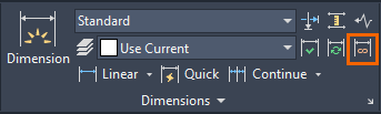

Associate or Reassociate a Dimension Using the Ribbon
With the annotation monitor active, let's associate some dimensions to geometry.
To make a dimension associative click Annotate tab > Dimensions panel > Reassociate
  1. Select one or more dimensions to associate or reassociate.
  2. Press Enter and do one of the following:
    • To associate the dimension to specific geometry, enter s (Select object) and select the geometry.
    • To reassociate, select the reference point on an object, using object snaps as needed, to associate the indicated extension line.
  3. Repeat steps as needed.
