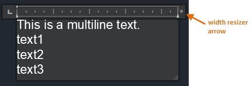

- Specify the opposite corners of a bounding box to define the width of the multiline text object.
The In-Place Text Editor and Text Editor ribbon contextual tab are displayed.
- Type the text below as you would in any word-processing application (for example, Microsoft Word).
Note: Some text can be difficult to read when it's very small, very large, or rotated. While editing multiline text, AutoCAD temporarily displays the text horizontally and at a legible size so that you can easily read and modify the multiline text. (MTEXTFIXED system variable)Tip: Double-click the width resizer arrow on the ruler to automatically confine the bounding box to the limits of the MText object. This method helps to better control the word wrapping of the MText.

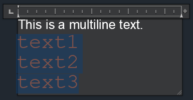

- Double-click the MText object created in the previous exercise.
- Select the text as shown in the illustration.

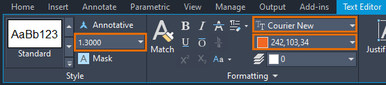

- On the Text Editor ribbon contextual tab, do the following to change the formatting of the characters in the MText:
- Choose a font from the list. For example, Courier New.
- Apply a color to the selected text.
- Change the character height of the selected text.

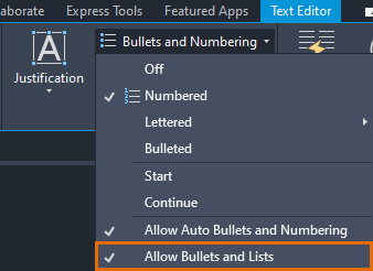

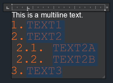

Convert the selected text to a list
- If the editor is still active, select the changed text. Otherwise, double-click the MText object and then select the changed text.
- On the Text Editor ribbon contextual tab, Paragraph panel, click Bullets and Numbering. Choose Numbered.
Note: List formatting is only available when the Allow Bullets and Lists option is selected.

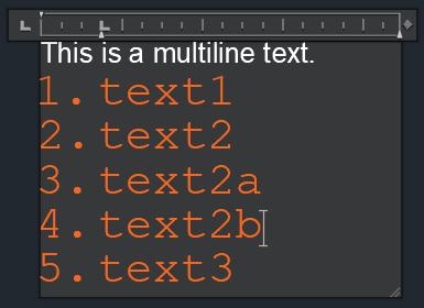

- To add new list items after text2, place your cursor after text2 and press Enter.
- Type
text2a for the list item. Press Enter and proceed to the next item, and type
text2b.

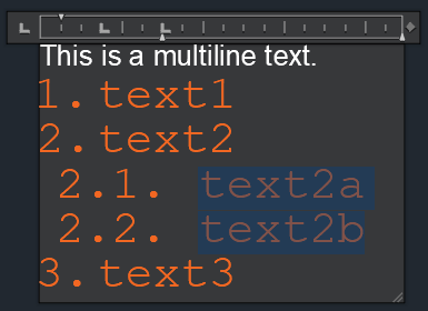

- Now, let’s create a sublist. Select text2a and text2b.
- Press Tab.
The list numbering automatically adjusts as you add an item or move items down a level.
Tip: To move a list item back up one level, press Shift+Tab. - Close the editor to save your changes.

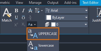

- Double-click the MText object with the list.
- Select the numbered items in the list.
- On the Text Editor ribbon contextual tab, Formatting panel, click Change Case. Choose UPPERCASE.
Tip: You can use keyboard shortcuts to quickly switch between lowercase (Ctrl+Shift+L) and uppercase (Ctrl+Shift+U).
- At the Command prompt, enter textallcaps and then enter on.
- On the Text Editor ribbon contextual tab, Tools panel, click All CAPS.

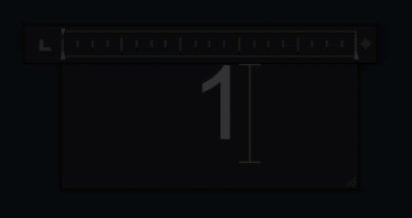

- Create a new MText object.
- In the In-Place Text Editor, type a numerator, for example, 1.
- Type one of the following characters to define the fraction format.
- Forward slash (/)—creates a horizontal fraction
- Number sign (#)—creates a diagonal fraction
- Type a denominator, for example, 2.
- Press the Spacebar or another valid character.
As you type, the fractions are stacked, and a lightning bolt icon
is displayed near the stacked text.

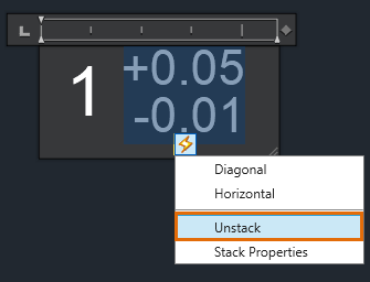

- To create a tolerance stack, enter a numeric character before and after a caret (^). For example, type
1 +0.05^-0.01 and then press the Spacebar.
- If you want to align the decimal point of the upper and lower numbers of the stacked text, click the lightning bolt icon and do the following:
- Choose Stack Properties.
- In the Stack Properties dialog box, under Appearance, click Style drop-down list.
- Choose Decimal.
- Click OK.
- To unstack the text, click the lightning bolt icon and choose Unstack.

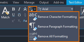

Remove formatting from MText
- Select just the text that you want to remove the formatting from, or press Ctrl+A to select the entire MText object.
- On the Text Editor ribbon contextual tab, Formatting panel, click Clear and choose from the available options:

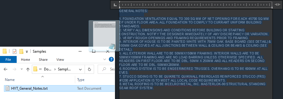

You can also use the drag-and-drop method to import a TXT file.
- Open File Explorer and make sure it does not fill the screen.
- Browse to the folder that contains the TXT file you want to import.
- Drag the TXT file onto the drawing window.
A new MText object is created with the text in the TXT file and formatted using the current text style.

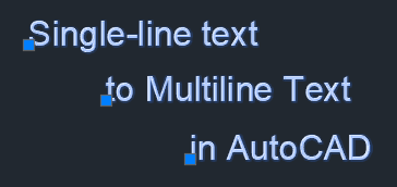

Occasionally, you might inherit a drawing from someone else containing single-line text objects that would be easier to manage if they were just one multiline text object. Let’s try converting the single-line text to MText.
- Open a drawing containing single-line text. You can also use the TEXT command to create some single-line text as shown below.
Compared to the several grips available on an MText object, a single-line text object has grips at its insertion and alignment points which are the same by default and in the lower-left corner.
- Click Insert tab
Import panel
Combine Text. Find
Alternatively, at the Command prompt, enter txt2mtxt.
- If you want to specify the text conversion settings, at the Select objects or [SEttings] prompt, enter se.
- Select one or more single-line text objects to convert to MText. Let’s select all three text objects.
- Press Enter to combine the selected text objects.
