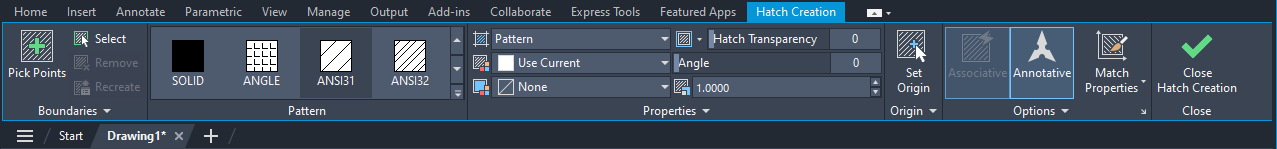

  1. Click Home tab > Draw panel > Hatch. Find
    Note: The Hatch Creation ribbon tab appears as soon as you start the command. This ribbon tab has just about everything you'll need when applying or editing a hatch. If the ribbon is off, you can turn it back on with the RIBBON command.

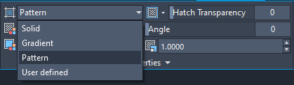

  2. On the Properties panel Hatch Type list, select the type of hatch that you want to use. For this exercise, let's choose Pattern.

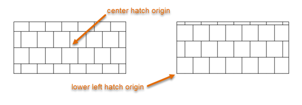

Hatch Scale, Angle, Origin
When applying or editing a hatch, you may want to assign properties like angle, scale, origin and so on.
  1. Select the hatch inside the rectangle.

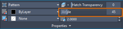

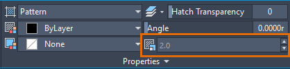

  2. To change the scale: on the Properties panel, enter a specific scale or use the up and down arrows to set the scale.
  3. To change the angle: on the Properties panel, enter a specific angle or use the slider to set the angle.

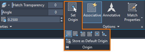

  4. To change the origin: on the Origin panel do one of the following:
    • Click Set Origin to pick an origin point on the drawing.
    • Expand the drop-down menu to choose from a set of predefined origin points.
    Note: If the hatch area is not a rectangle shape, the rectangular extents are used for the predefined origin points.
Note: The center grip does not change position when the hatch origin is changed.

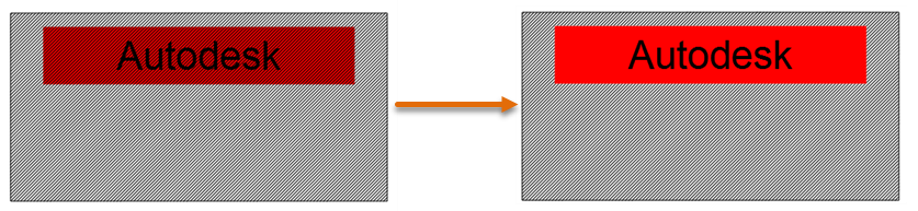

Have you ever added hatch to a drawing and the hatch appears on top of or overlaps other objects? You can use draw order to move the hatch forward or backward in the drawing.
  1. Insert an mtext object on top of the rectangular hatch. You can also define a background mask color for the mtext object if you want.
  2. Select the hatch inside the rectangle.
  3. Right-click and select Draw Order > Send to Back.
Note: You can preset the hatch order with the HPDRAWORDER system variable. However, this system variable is not saved and reverts to the default, behind hatch boundary objects, with each drawing or AutoCAD session.
