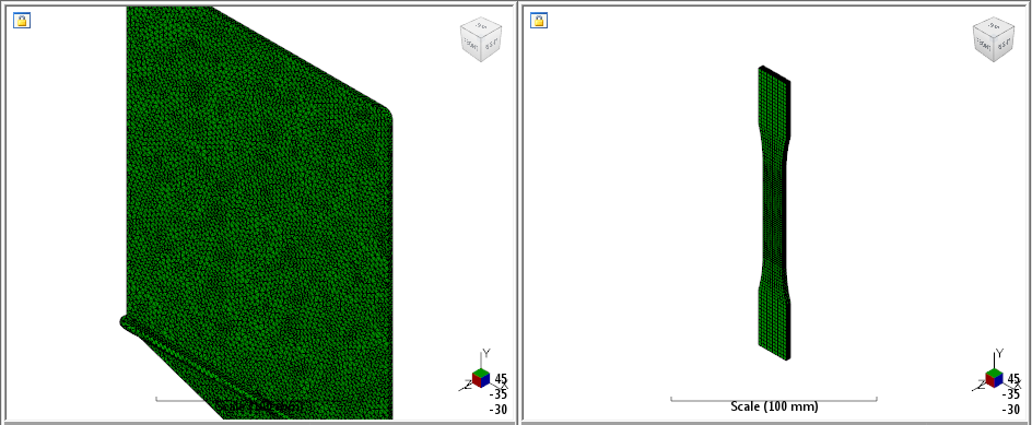

This tutorial guides you through the analysis of an ASTM coupon specimen which has been machined from an injection-molded plaque. An injection molding simulation is performed with Moldflow and the coupon is created with Inventor Nastran In-CAD. Advanced Material Exchange is used to map fiber orientations to the structural model and characterize the nonlinear material behavior. Finally, a structural analysis is performed and results are evaluated in Inventor Nastran In-CAD.
This tutorial is based on ASTM D638-10 for tensile testing of plastic materials. The major goal of this tutorial is to demonstrate that the material models used by Advanced Material Exchange can accurately reproduce the experimental stress-strain response of the material. We will also examine some of the key solution variables produced by Advanced Material Exchange that can help evaluate the structural life of your part.
