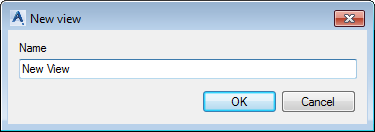

  3. Enter a name for the new view:

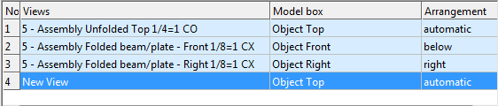

    The new view appears in the tree and in the list.
  4. You can assign a model box and a view arrangement to the new view. This does not affect the original view.

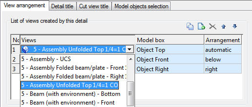

  1. On the properties panel, click (Add existing view).
  2. Select a view from the tree and click OK. The selected view appears in the tree and in the list. You can assign a model box and a view arrangement to the new view. This does not affect the original view.
