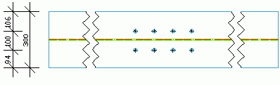

Create a separate dimension chain for each item marked with*
If this option is checked, a dimension chain is created for each single object detected in the model (e.g. bolt pattern). If this option is not checked, all the detected objects are dimensioned in one dimension chain.
Option Result
Abbreviation: A (All)
Create a separate dimension chain for each item marked with* - box unchecked
Abbreviation: S (Single)
Create a separate dimension chain for each item marked with* - box checked
A bolt pattern creates only one dimension chain because it is just one object.

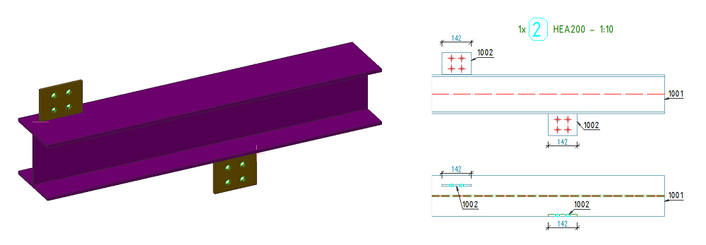

This option creates separate dimension chains for each individual object (the object can be a feature, such as a cut or a cope or it can be an attached beam or plate) on the drawing. Use this option to also automatically arrange the dimensions on the corresponding side of the targeted objects.
Examples

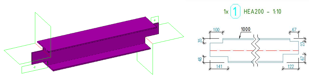

Cope cut found at beam ends:

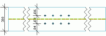

Attached plates that require individual dimensions:
