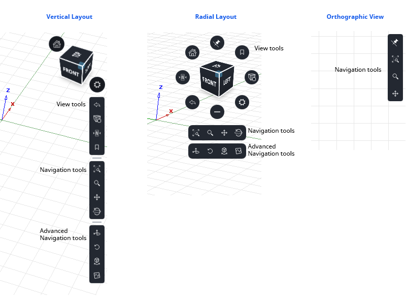

The navigation tools (NavBar) are associated with the Viewcube and can be accessed or displayed by:
  • Pressing Shift + Alt
  • Moving the cursor towards the ViewCube and NavBar area. In a multi-window layout, click in a window first to make it active.
The NavBar tools can appear in three different formats:
In vertical mode, the two navigation tools sections can be collapsed by clicking the horizontal line between the sections.
In radial mode, the two navigation tools sections can be displayed or hidden using the +/- icon.

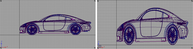

Non-Proportional Scale view
A non-proportional view is scaled in one direction to compress the view, typically to evaluate surface or curve flow. It is a method of viewing that you might do if you looked at the side of a car from the front three-quarters to compress the view.
Click and drag on the Non-Proportional Scale icon to modify the view.
In a perspective view you can only distort the view horizontally.
In an orthographic view you can use the mouse buttons to control the distortion:
  • Left - Free adjustment in the screen plane
  • Middle - Horizontal adjustment only
  • Right - Vertical adjustment only
When a distorted view has been set, the icon is displayed with a thin blue border to indicate that a distorted view has been set. Click-release to switch between the non-proportional (distorted) view and the default (non-distorted) view.
Note: A Non-Proportional View icon is displayed in the lower left hand corner of the window when the view is non-proportional.
