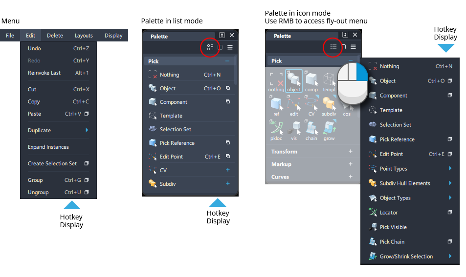

Hotkeys can be viewed and modified using the Preferences > Hotkeys/Menus Editor.
Assigned hotkeys are shown on Palette and Menu tools next to the tool name when in list mode. When the palette is displayed in icon mode, use the right mouse button on a tab header to display the fly-out menu in list mode.
Promptline hotkey mode

Tab or clicking in the promptline is required for both modes.Palette default hotkey assignments
Hotkeys assigned to palette items are only displayed when the palette is in text/menu display mode or by using the right mouse button on the palette tab header in icon view.
