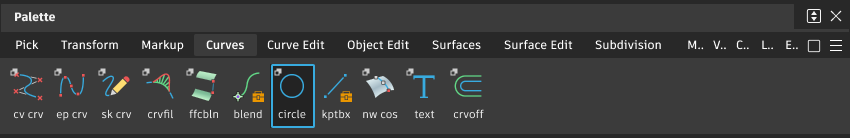

Circle
Creates a NURBS curve in the form of a planar circle.
Access this tool from the Curves tool palette:
