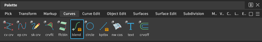

Access the Blend Curve Toolbox from the Curves tool palette:

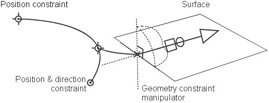

Blend curves are controlled by blend points acting as constraints:

Types of blend points
There are three main types of blend points.
  • Location: forces the curve to pass through the blend point’s location in space.
    This is the type you create when you first draw a blend curve.
  • Direction: forces the curve to pass through the blend point’s location in space traveling in a certain world space direction.
    There are two subtypes of direction:
    • Directed: you set an actual direction for the curve tangent. Use this type when the specific tangent direction at the point of the blend point is important.
    • Parallel: you set a line along which the curve passes (in either direction) at the blend point. This is easier to enforce and results in better curve continuity.
  • Geometry: forces the curve to pass through a point on a curve or surface and travel in a direction relative to that curve or surface.
