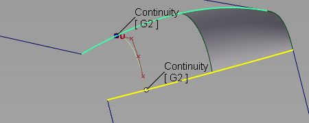

Creates a curve that blends between two existing curves, curves-on-surface, or edges.

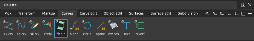

Access this tool from the Curves tool palette:

Side 1/2 Continuity
Choose G0 Position, G1 Tangent, G2 curvature or G3 curvature to determine the type of continuity that will be used between the curve blend and primary curves. You can specify the continuity settings independently along both sets of boundaries.
G2 curvature continuity means that the curvature (which is the inverse of the radius of curvature) is the same on both sides across the curve's boundaries. The V degree of the curve blend is adjusted so that the curve has enough CVs to provide the required continuity on both sides. Degree 4 is needed for G2 continuity on one side, and degree 5 is needed for G2 continuity on both sides
G3 curvature continuity means that the curvature's rate of change is the same on both sides across the curve's boundaries. The V degree of the curve is adjusted so that the curve has enough CVs to provide the required continuity on both sides. Degree 6 is needed for G3 continuity on one side, and degree 7 is needed for G3 continuity on both sides.

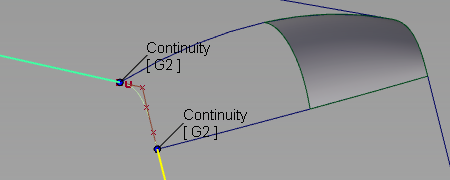

Freeform Curve Blend workflow
Use the Freeform Curve Blend tool to create curves that blend between curves and surface edges using the same Form Factor control used in other Alias tools (Surface Fillet, and Freeform Blend).
To create a freeform curve blend
  1. Shift-select the Freeform Curve Blend tool.
  2. Select the curve or surface edge where you want the curve blend to start.
  3. Drag the curve blend point to the exact location, as needed.
  4. Select the curve or surface edge where you want the curve blend to end.
  5. Drag the curve blend point to the exact location, as needed.
  6. Set the desired Continuity and Alignment at each side of the blend, and set Blend Control options.
  7. Click Build.
