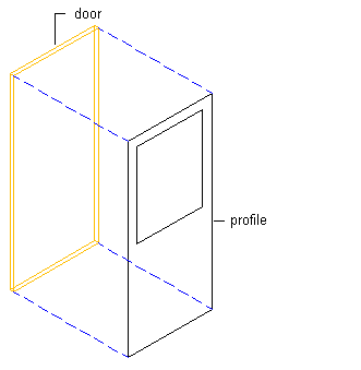

Use this procedure to create a door style with glass for doors to accept muntin patterns.
The drawing must contain a profile that defines the door style and the void for the door glass.
Door profile with a void for glass
Door style created from the profile
