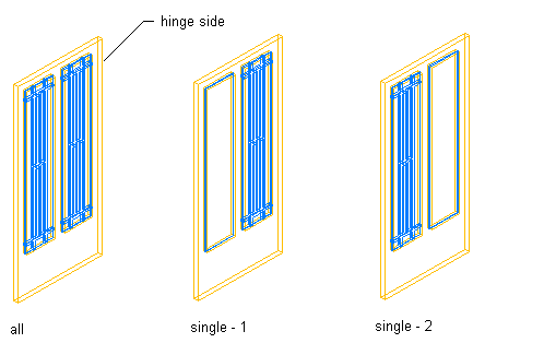

  8. If the door style contains multiple glass components, specify whether you want to apply muntins to all glass components or to one glass component in the door:
    If you want to… Then…
    attach muntins to all glass components under Glass Component, select All.
    apply muntins to an individual glass component under Glass Component, select Single, and specify the index number. Lights are indexed counterclockwise, starting from the lower-left corner.
    Muntins applied to all or one glass component

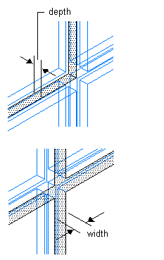

  9. Enter a value for the width and depth of all muntins.
    Specifying muntin width and depth

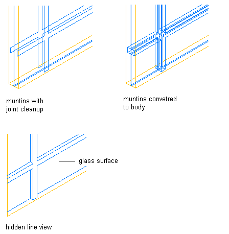

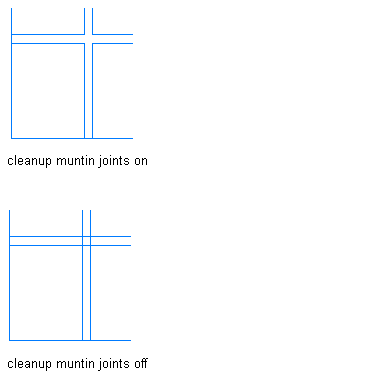

  10. Clean up the muntin intersections:
    convert the muntin intersections to corners under Muntin, select Clean Up Joints.
    convert all the muntins to one body with the joints cleaned up under Muntin, select Convert to Body.
    Specifying muntin cleanup joints
    Converting muntins to a body

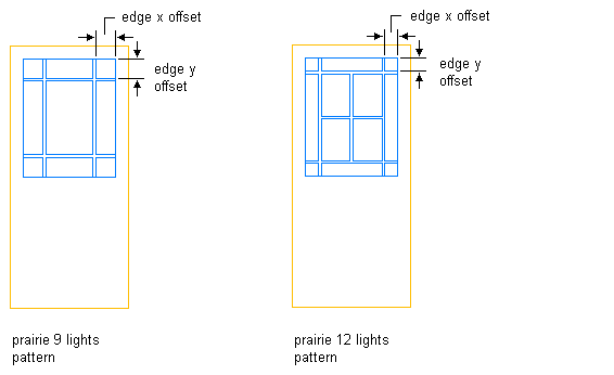

  11. Under Lights, select a pattern:
    use a nine-light prairie pattern select Prairie-9 Lights for Pattern.
    use a twelve-light prairie pattern select Prairie-12 Lights for Pattern.
  12. Enter a value for Edge X Offset to specify the horizontal distance of the muntins from the edges of the glass.
  13. Enter a value for Edge Y Offset to specify the vertical distance of the muntins from the edges of the glass.
    Specifying edge X and Y offsets
