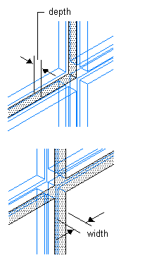

  9. Enter a value for the width and depth of all muntins.
    Specifying muntin width and depth

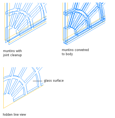

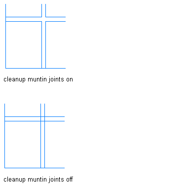

  10. Clean up the muntin intersections:
    If you want to… Then…
    convert the muntin intersections to corners under Muntin, select Clean Up Joints.
    convert all the muntins to one body with the joints cleaned up under Muntin, select Convert to Body.
    Specifying muntin cleanup joints
    Converting muntins to a body

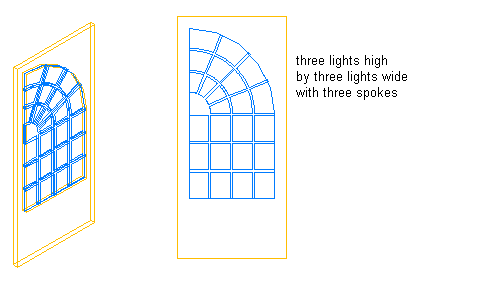

  13. Enter a value for Lights High to specify the number of light rows in the vertical direction, exclusive of the spoked lights.
  14. Enter a value for Lights Wide to specify the number of light columns in the horizontal direction.
    Count the columns as though they continue around the hub. For a half-round sunburst, five apparent columns are counted as two. For a quarter-round sunburst, three apparent columns are also counted as two.

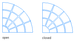

  16. Under Hub Style, select Closed for no hub light, or select Open for a hub light.
    Specifying closed and open hubs

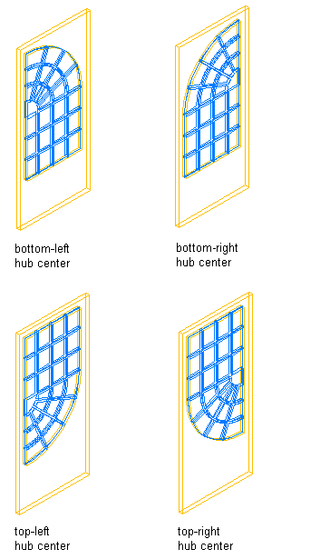

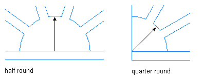

  18. Specify where to place the hub:
    place the hub at the bottom of a half-round shape under Hub, select Bottom Center.
    place the hub at the top of a half-round shape under Hub, select Top Center.
    place the hub at the bottom left of a quarter-round shape under Hub, select Bottom Left.
    place the hub at the bottom right of a quarter-round shape under Hub, select Bottom Right.
    place the hub at the top left of a quarter-round shape under Hub, select Top Left.
    place the hub at the top right of a quarter-round shape under Hub, select Top Right.
    Specifying hub placement of quarter-round shape
