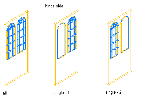

- If the door style contains multiple glass components, specify whether you want to apply muntins to all glass components or to one glass component in the door:
If you want to… Then… attach muntins to all glass components under Glass Component, select All. apply muntins to an individual glass component under Glass Component, select Single, and specify the index number. Lights are indexed counterclockwise, starting from the lower-left corner.
Muntins applied to all or one glass component

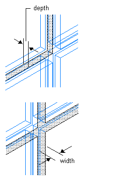

- Enter a value for the width and depth of all muntins.
Specifying muntin width and depth

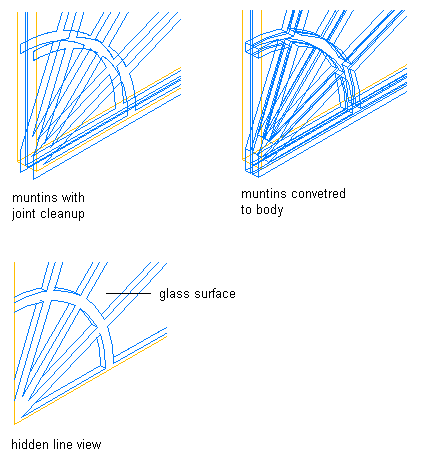

- Clean up the muntin intersections:
If you want to… Then… convert the muntin intersections to corners under Muntin, select Clean Up Joints. convert all the muntins to one body with the joints cleaned up under Muntin, select Convert to Body.
Specifying muntin cleanup joints
Converting muntins to a body

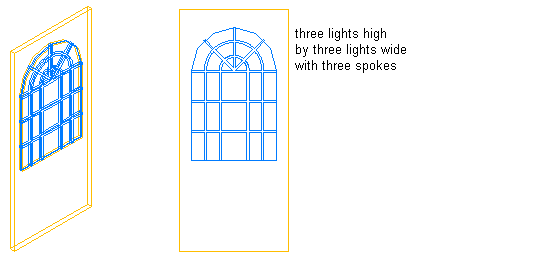

- Enter a value for Lights High to specify the number of light rows in the vertical direction, exclusive of the spoked lights.
- Enter a value for Lights Wide to specify the number of light columns in the horizontal direction.
Count the columns as though they continue around the hub. For a half-round starburst, five apparent columns are counted as three. For a quarter-round starburst, three apparent columns are also counted as three.
- Enter a value for Spokes to specify the number of radial muntin spokes.
Specifying the number of radial muntin spokes

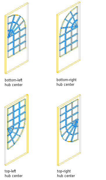

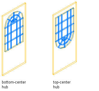

- Specify where to place the hub:
If you want to… Then… place the hub at the bottom of a half-round shape under Hub, select Bottom Center. place the hub at the top of a half-round shape under Hub, select Top Center. place the hub at the bottom left of a quarter-round shape under Hub, select Bottom Left. place the hub at the bottom right of a quarter-round shape under Hub, select Bottom Right. place the hub at the top left of a quarter-round shape under Hub, select Top Left. place the hub at the top right of a quarter-round shape under Hub, select Top Right.
Specifying hub placement of half-round shape
Specifying hub placement of quarter-round shape
