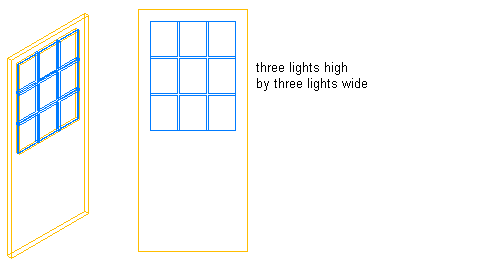

Rectangular door glass with rectangular muntins

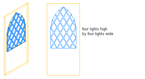

Gothic door glass with diamond muntins

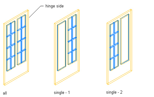

- If the door style contains multiple glass components, specify whether you want to apply muntins to all glass components or to one glass component in the door:
If you want to… Then… attach muntins to all glass components under Glass Component, select All. apply muntins to an individual glass component under Glass Component, select Single, and specify the index number. Lights are indexed counterclockwise, starting from the lower-left corner.
Muntins applied to all or one glass component

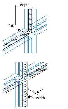

- Enter a value for the width and depth of all muntins.
Specifying muntin width and depth

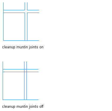

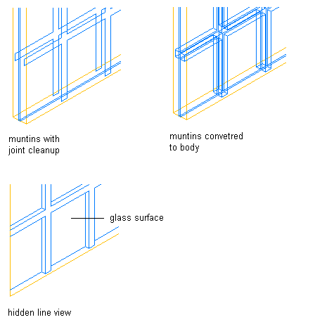

- Clean up the muntin intersections:
If you want to… Then… convert the muntin intersections to corners under Muntin, select Clean Up Joints. convert all the muntins to one body with the joints cleaned up under Muntin, select Convert to Body.
Specifying muntin cleanup joints
Converting muntins to a body

If you want to… Then… use a rectangular pattern select Rectangular for pattern. use a diamond pattern select Diamond for pattern. - Enter a value for Lights High to specify the number of light rows in the vertical direction.
- Enter a value for Lights Wide to specify the number of light columns in the horizontal direction.
Values for lights high and lights wide
