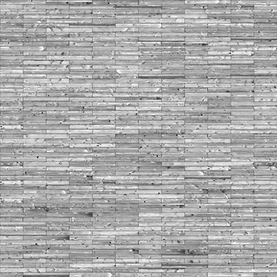

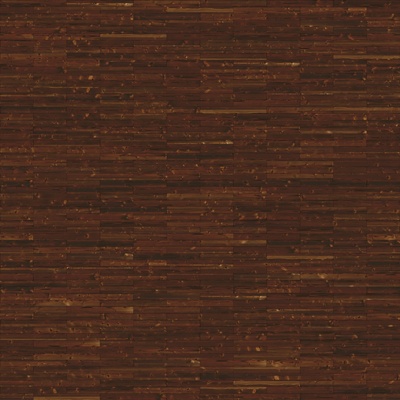

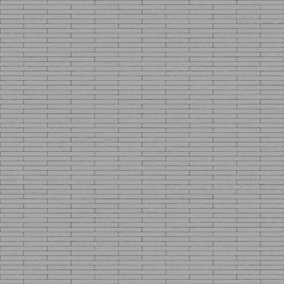

- Below are the wood textures used in this example.
| Specular map | Diffuse map | Bump map |

- Connect the diffuse map to the Base Color attribute.
- Connect the specular map to the Specular Color and Specular Weight attributes.
- Connect the bump map to the Bump Mapping parameter.
Bump Mapping

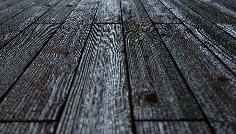

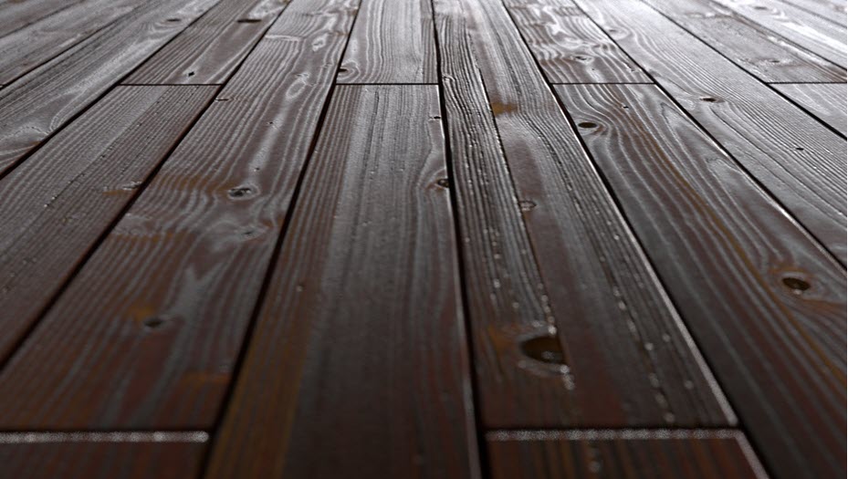

Only a very subtle Bump Depth value is required.
| Bump depth: 1 (too much) | Bump depth: 0.1 |
