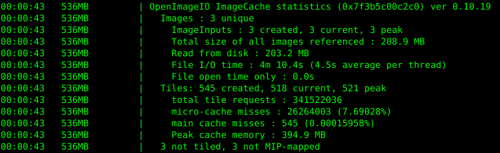

When textures are used, the log displays statistics from the OpenImageIO ImageCache.
Your stats will be different as it's dependent on the power of your machine. Take a note of your stats to use as a comparison later.
  • Render Time - 00:00:43
  • File I/O time: 4m 10.4s
  • Peak cache memory: 394.9 MB

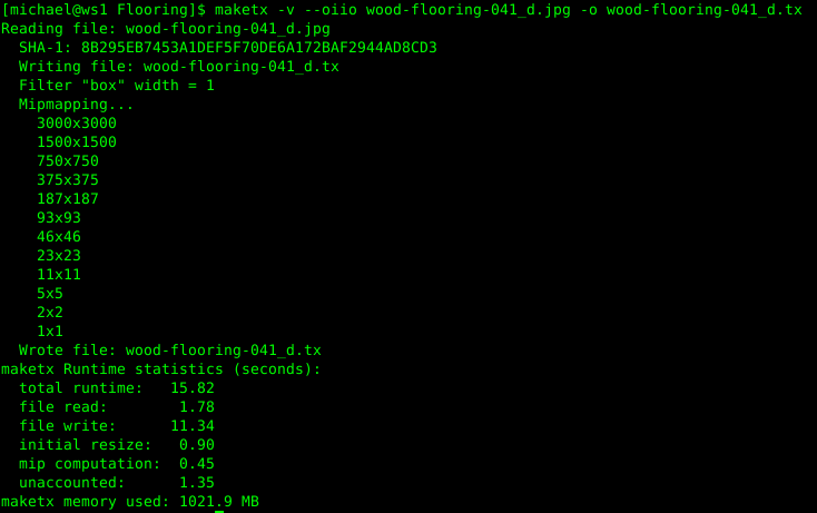

Textures will be converted with the maketx, a command-line utility which is part of OpenImage IO.
  • On Linux, open a terminal and navigate to the location of your textures and run the following command:
maketx -v --oiio wood-flooring-041_d.jpg -o wood-flooring-041_d.tx
The -v flag is verbose, to output the status messages. The flag --oiio will generate .tx files optimized for Arnold that can render even faster by forcing the tile size to be optimal for OpenImageIO (64x64). It also stores channels interleaved (RGBARGBA...) making them faster to read and enables constant color detection: if the image is a constant color it will convert it to a tiny single color .tx file. -o must come before the output file.
  • Convert the other textures in the same way.

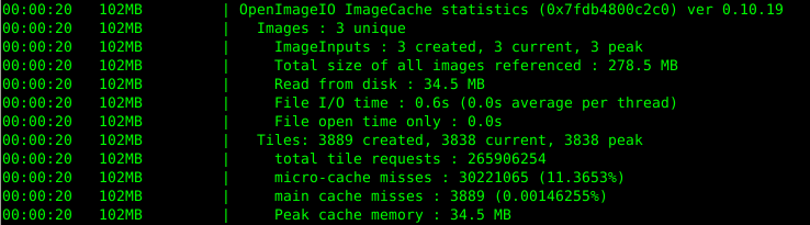

Render again, and it should be obvious that the render is much faster. Take a look at the log for the statistics.
  • Render Time - 00:00:20
  • File I/O time: 0.6s
  • Peak cache memory: 34.5 MB
Compared to the original render, the render time is now less than half. File I/O is virtually nothing, and the cache memory used is 9% of what it was. Well, that should convince you it's worth taking a little more time, in the beginning, to convert textures, as it will save a lot of render time.
