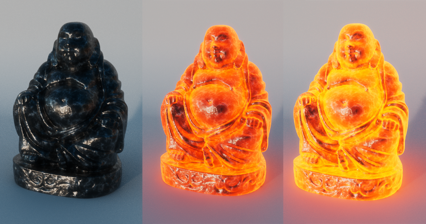

Incandescent Metal Material - Arnold for Houdini
This simple tutorial demonstrates how to create an incandescent metal material. It uses a variety of shaders such as Facing Ratio, Range, Multiply, and Cell Noise connected to the Emission Color of the Standard Surface shader. Thanks to Slava Sych for the assistance with this tutorial.

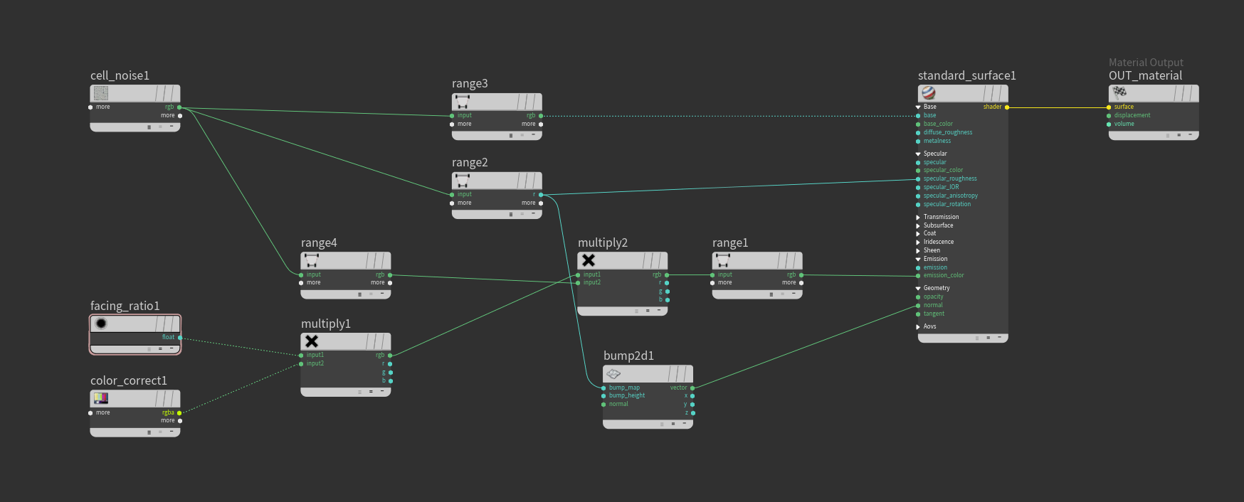

Facing Ratio
Create a Facing Ratio shader and change the following parameters:
  • Bias: 0.6
  • Gain: 0.48
  • Linear: Enabled
  • Invert: Enabled
Color Correct
  • Create a Color Correct shader. Change the input color RGBA to: 2.9642 0.5212 0 1
Connect the Facing Ratio shader and Color Correct shaders to a Multiply shader (multiply1).
Range Shader (range4)
Create another Range shader and change the following parameters:
  • Input Min: 0.249
  • Input Max: 0.484
  • Output Min: 0.7
  • Output Max: 1
  • Enable Smoothstep
  • Connect the Cell Noise shader (cell_noise1) to the Input of the Range shader (range4).
  • Create a Multiply shader (multiply2). Connect multiply1 to the Input 1 of multiply2.
  • Connect the Range shader (range4) to Input2 of multiply2.
Range shader (range 1)
Create a Range shader.
  • Change the Output Max to 3.
  • Connect the Multiply shader (multiply2) to the Input of Range shader (range1). This is required for the higher value color intensity values.
  • Connect the Range shader (range1) to the Emission Color of the Standard Surface shader.
Now it is possible to control the incandescence using the Emission Weight (0 to 1). If you require more intensity, increase the Output Max value in Range shader (range1).
Final shading network
