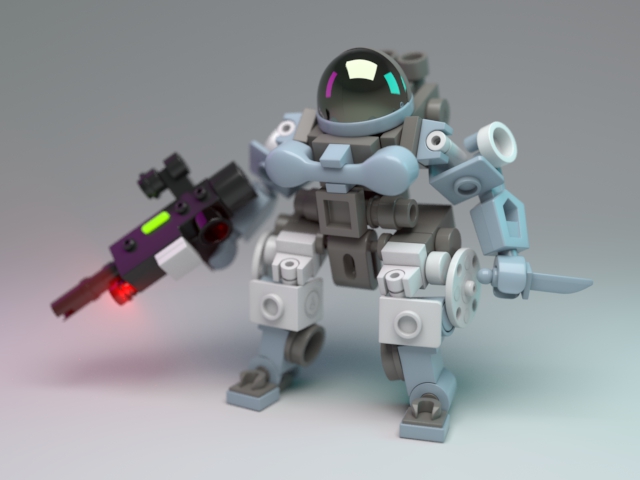

Beauty render | Specular LPE AOV |
Light Path Expressions (LPEs) are useful for outputting light into specific AOVs. LPEs describe the transport of light through the scene, starting from a source of light, bouncing between objects, and finally ending up at the camera. LPEs can be used to extract specific light contributions from Arnold into separate built-in or custom AOVs which can be output and recombined in various ways in a compositing package.

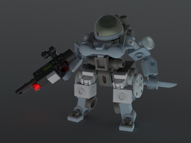

Built-in LPE AOVs
LPEs are not particularly artist-friendly, and so a list of built-in LPE AOVs are provided in Arnold. Below are some examples of the built-in light path expression AOVs that have been used in this scene.

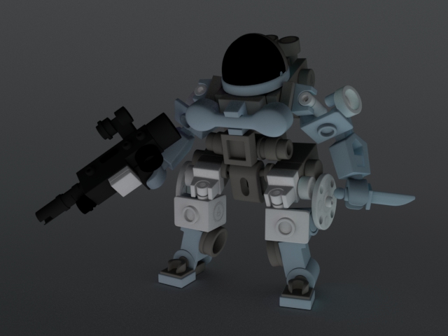

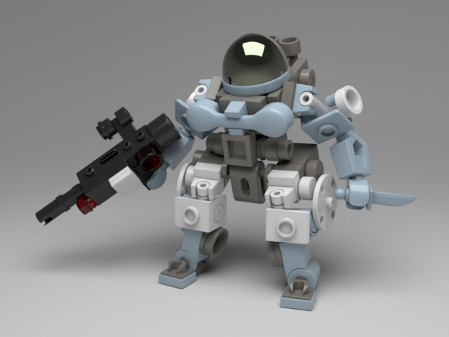

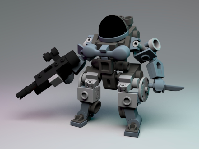

Beauty: C.* |
Diffuse Albedo: C<RD>A |
Diffuse Direct: C<RD>L |
Diffuse Indirect: C<RD>[DSVOB].* |

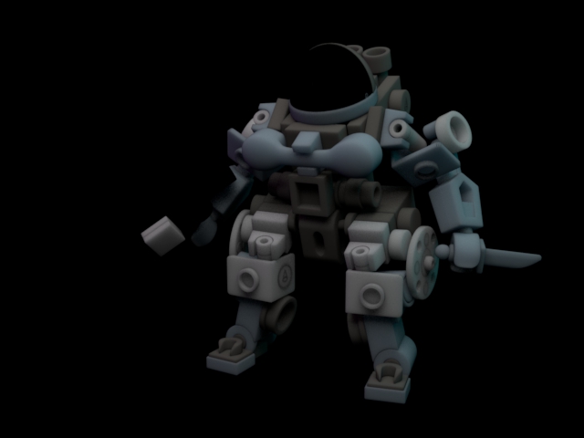

Diffuse: C<RD>.* |
Direct: C[DSV]L |
Emission: C[LO] |
Indirect: C[DSV/][DSVOB].* |

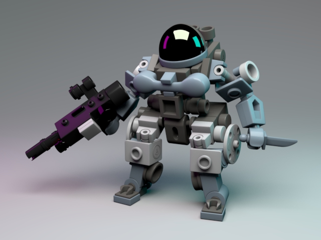

Specular Direct: C<RS>L |
Specular Indirect: C<RS>[DSVOB]./* |
Specular: C<RS>.* |

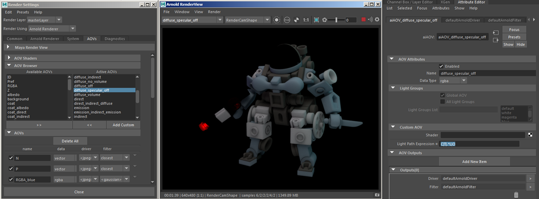

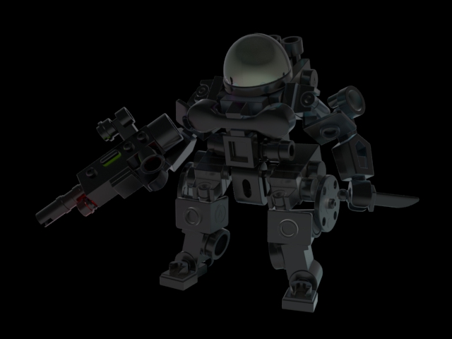

Custom AOV with LPE 'C[T].*L|O' entered in AOV node and viewed in Arnold RenderView
Custom AOVs
The built-in AOVs are suitable for most tasks. However, custom AOVs can give more control when using LPEs. For example, you can choose combinations of LPEs to use when rendering the scene.
Example
In the example below C[ST].*[LO]
renders specular and transmission [ST]. Diffuse (D
) has not been used in this case, and therefore the background is not rendered as it only has a diffuse component.

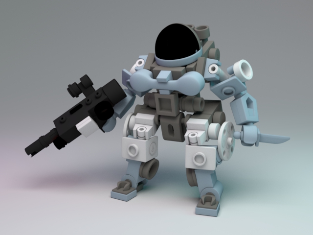

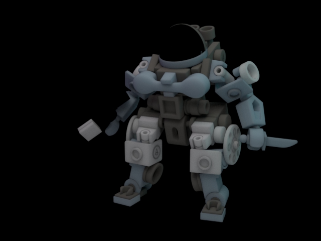

Transmission: C[T].*[LO] |

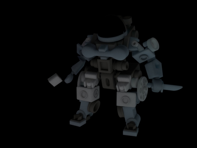

Specular, Transmission: C[ST].*[LO] |

Diffuse: CD.*L |

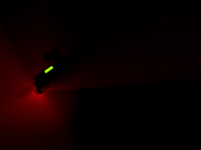

Emission + Emission Indirect: C.*O |
Emission: C[LO] |

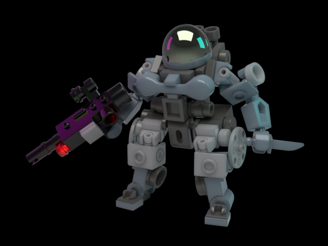

It is also possible to output per light AOVs. Combining light groups with LPEs can be a powerful tool when compositing AOVs. By default, LPEs use all of the lights in the scene. We can limit the light contribution from single or multiple lights using light groups.
In this case, we have used the following AOV Light Group names for each light: key light (white), rim light1 (magenta), and rim light2 (blue).
We will add a custom AOV, for example, an "RGBA_" prefix. The light group name for the blue rim light would therefore be "RGBA_ blue".
RGBA has been used in this example, but you can use any other [LPE].

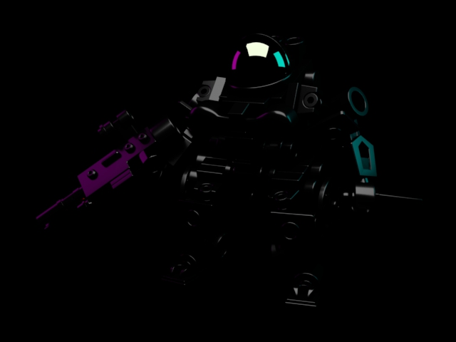

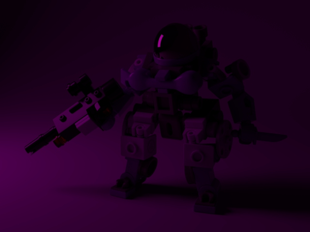

Key light AOV: RGBA_white | Rim light1 AOV: RGBA_magenta | Rim light2 AOV: RGBA_blue |

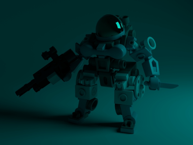

- Now we can use the <L.'groupname'> syntax to isolate the specular reflection contribution from the blue light using the following expression:
C<RS><L.' blue '>.*
For light group AOVs, using <L.> is required instead of just L.
Specular reflection from blue rim light: C<RS><L.'blue'>.* |

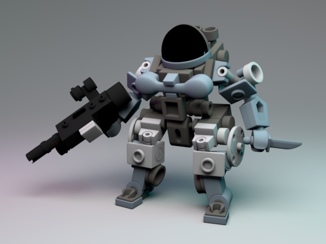

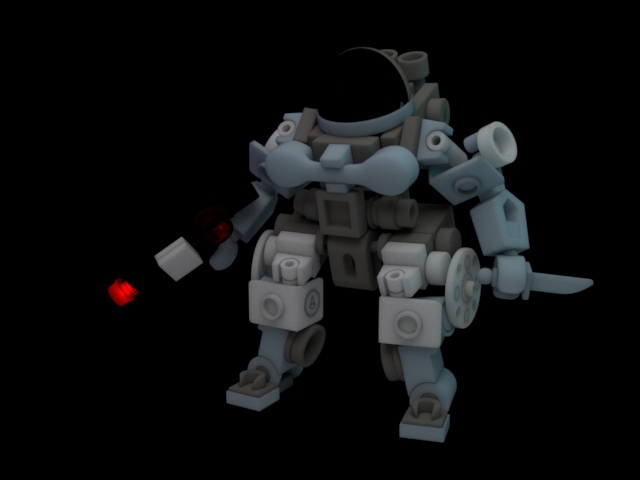

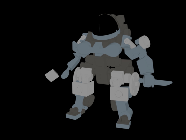

We can restrict expressions to specific shader parameters. In the example below, C<RS[^'coat']>.*
has been used to render the scene without coating. The helmet shader is therefore not apparent in the rendered image when Coat is at 1. However, specular (RS) is visible in the helmet when Coat is below 1.
Helmet is invisible when its Coat value is 1 | Specular only |
