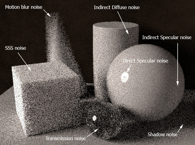

The first step in removing noise from your renders is to identify where it is coming from. Noise can be caused by:
Insufficient Sampling:
Motion Blur
Depth Of Field
Diffuse
Specular
Shadow
Indirect Specular
Transmission
SSS
Atmospheric Volume
Other:
Fireflies
Non-energy conserving shaders, networks or settings
Noise nearly always comes from insufficient sampling, but increasing sampling for the wrong rays can make the render times increase without helping to remove the noise. As an artist is usually working to a render time limit or amount of rays the aim is to allocate those rays as effectively as possible to minimize the noise in the most efficient manner. So if the Camera (AA) samples have to be increased to remove DOF noise, the other settings must be lowered to keep render times manageable. However, if DOF or motion blur is not a concern, then increasing Camera (AA) samples would fix all noise elsewhere but would also slow render times from the unnecessary rays.

The most efficient method for identifying noise is to render AOVs. This can help save time by reducing the need to adjust settings unnecessarily.
AOVs

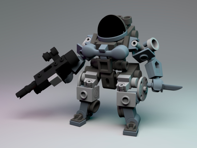

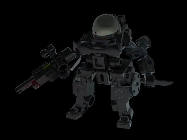

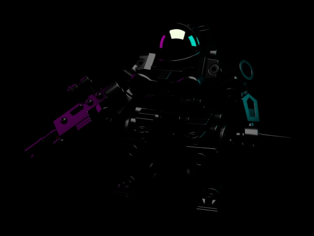

| diffuse_direct | diffuse_indirect | specular_direct |
| specular indirect | sss | transmission |
In the examples below the smoother option is shown with samples of 10. This is a very high value and is only used here because the Camera (AA) samples and all other samples are at 1 for an illustrative effect to contrast the noisy and smooth areas. Normally the Camera (AA) samples would be around 4-8, and as it acts as a multiplier, similar values would be needed for the other samples.

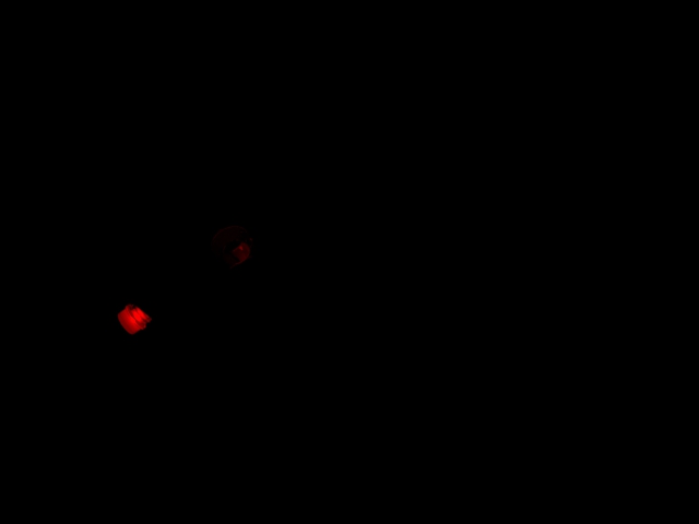

| All samples: 1 | Specular samples: 10 |
Indirect specular noise occurs when the specular roughness parameter > 0. The easiest way to confirm the cause is to check the indirect specular AOV. Another method is to set specular samples to 0 which will remove blurred reflections. If the noise disappears, then it is created by indirect specular.
Indirect specular noise is caused by a lack of specular samples. These samples control the number of rays fired when computing the reflected indirect-radiance integrated over the hemisphere weighted by a specular BRDF. The exact number of rays is the square of this value. Increase this number to reduce the indirect specular noise. Remember that the sampling is done for each Camera (AA) sample, so high values for both Camera (AA) samples and specular samples will tend to result in slow renders.

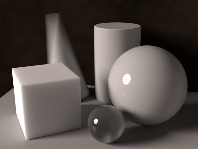

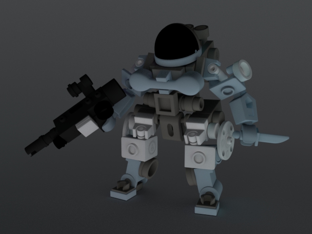

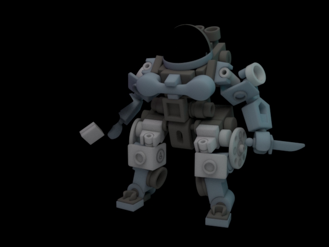

Clean Renders
No DOF
Camera (AA) samples: 7, diffuse samples: 3, specular samples: 2, transmission samples: 6, sss samples: 4, light samples: 3.
With DOF
Camera (AA) samples: 15, diffuse samples: 1, specular samples: 1, transmission samples: 4, sss samples: 3, light samples: 3.
