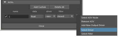

First, open the Render Settings window and go to the AOVs tab. Create a Z depth AOV.
Under AOVs, to the right of the newly created 'Z' AOV, there is a downward pointing arrow. Click on that and choose Select Driver from the menu.
- The Arnold driver should appear in the attribute editor. Select Merge AOVs. This will combine the 'Z' AOV with the rendered EXR as one file.
